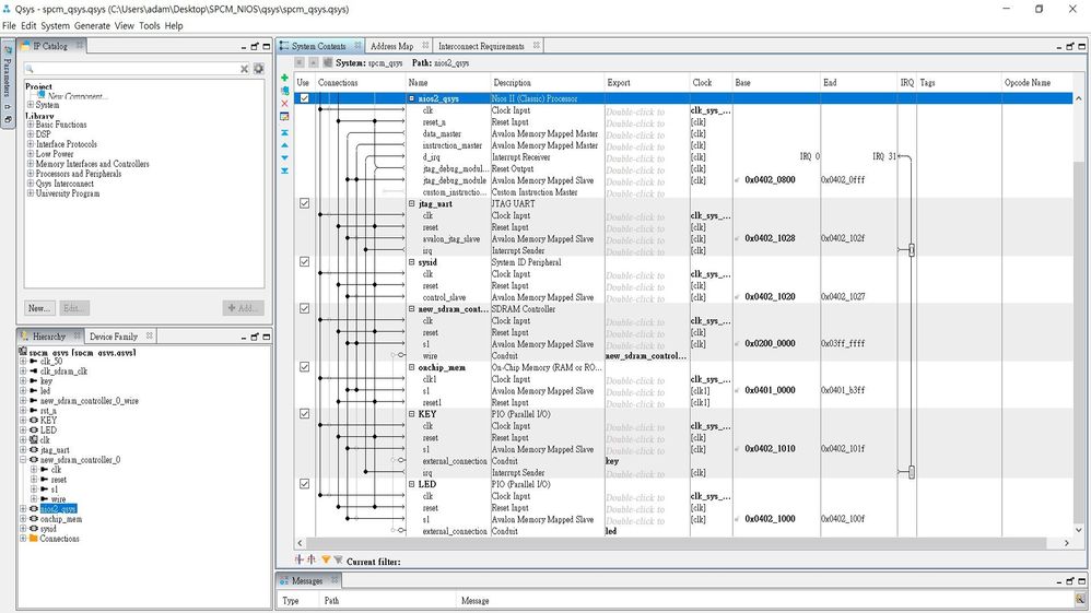

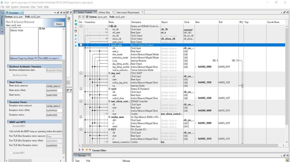

    • adamS's avatar
      adamS
      Hi Johi,
      Thanks for the reply,
      my qsys and top level are as below,
      I use the onchip memory as nios2 cpu's memory.
      Yes, it's very likely that data is written into the zone that is for other purpose,
      is there any way to avoid it?
      adam
