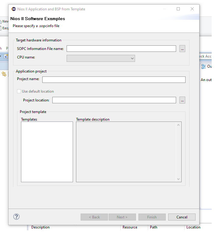

Template is empty in the Nios II application and BSP from Template
Dear Support
I installed the Nios II Eclipse on a new windows 10 machine. I have an old win10 works OK, I thought I installed the software package followed the same procedure, but I might missed some steps.
I knew when I choose file ->new -->nios II application and BSP from Template. the templates( like "hello world") will show on the templates area on the old PC, but the new installed pc this area is empty.
both of PC are using Quartus is 21.3.
I hope there will be some knowledge/procedures to trouble this kind of problem, if not I guess all I can do will be remove all the installed software and re-install them again. pretty painful and if I don't know what is wrong, I am not confident that re-install will solve the problem.

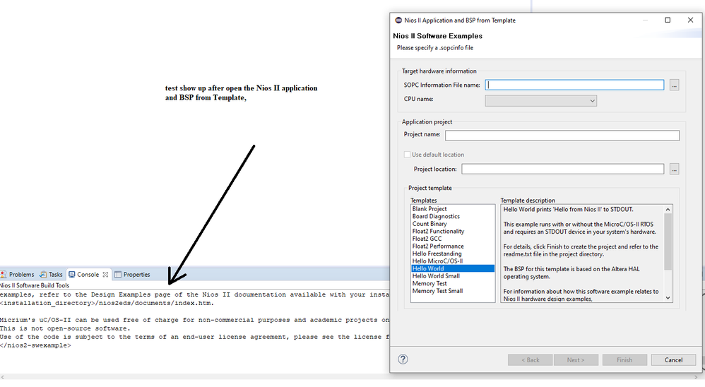

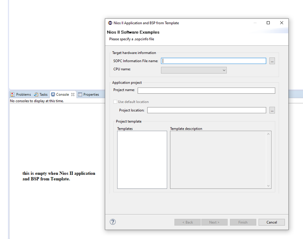

  • I also noticed that the Nios II- Eclipse console window are different.
    for the working machine, the console will show some text after open the Nios II application and BSB from Template. I hope with this information it will be an easy fix.
    on the not working machine, after open the Nios II application and BSB from Template. the console is empty.

      Here are the full text from the working console, where and who start executing: nios2-swexample-create.exe --describeAll (c:\intelfpga_pro\21.3\quartus\bin64)? why my new installed machine not start to run this command? I think it is close to the answer. appreciate your help.

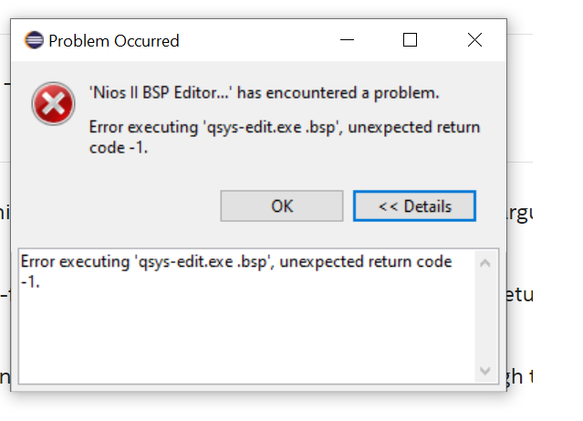

        I also notice that when I run Nios II----> BSP editor. I will have the following error message.
        any ideas.
