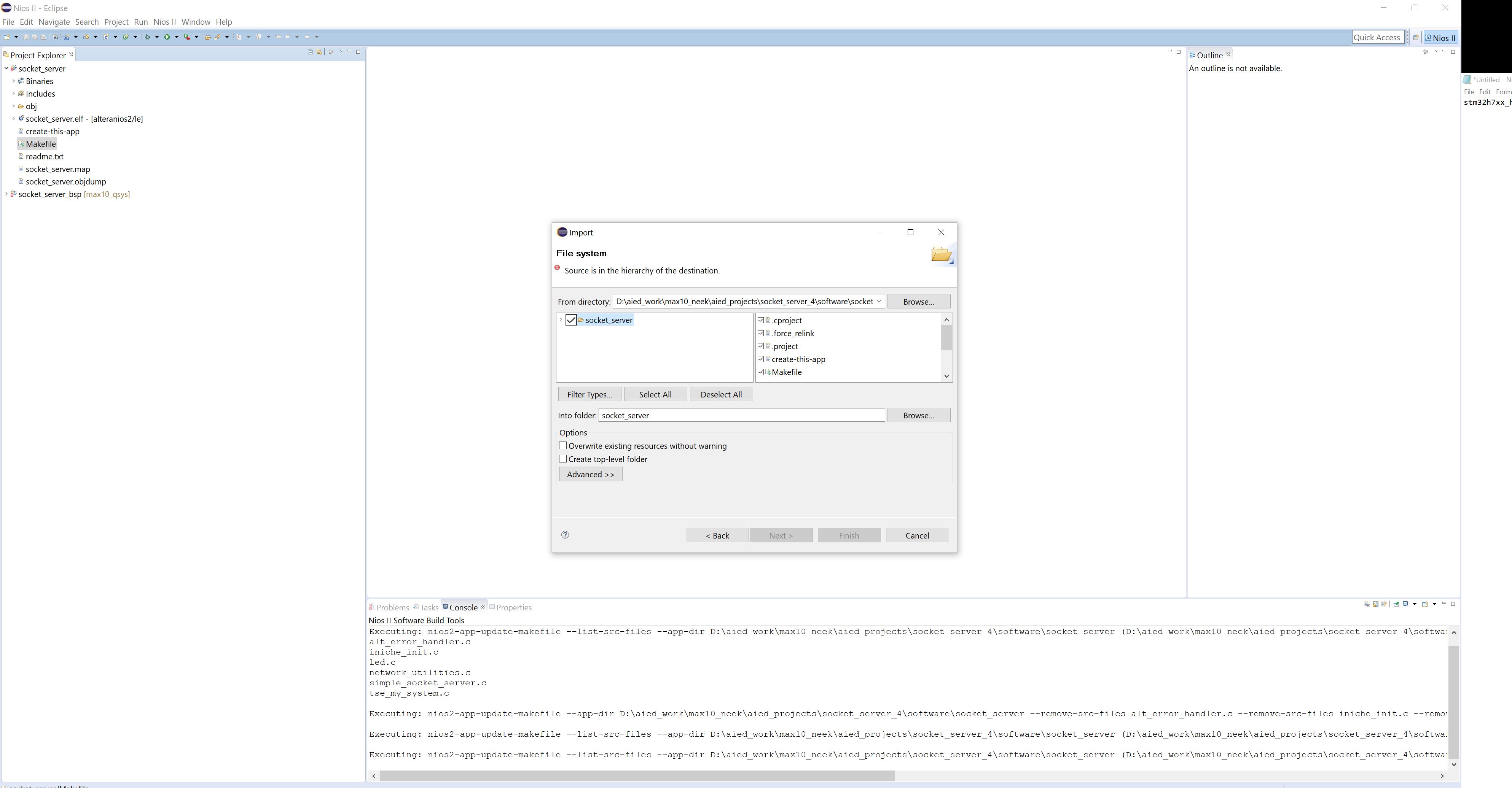

- aiedb
hii i tried the first option
i deleted the files and when i tried to add them , by the 4 step process you described i didn't manage to add the . i got stuck in this window(see the picture attached ) , and there is no next or finish tab, how can i add the .c .h files back to the project ??? thanks for your help
- ShengN_altera
Hi @aiedb ,
I think you're over browse. Browse until ..\socket_server_4\software will be enough and tick the following files:
alt_error_handler.c
alt_error_handler.h
iniche_init.c
led.c
network_utilities.c
network_utilities.h
simple_socket_server.c
simple_socket_server.h
tse_my_system.c
Sheng
