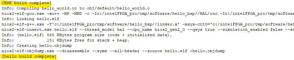

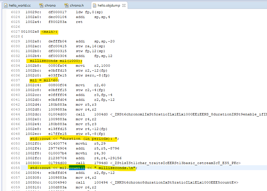

The screenshot is just to show the application is able to run with the chrono library.
Try to compile/build all even when you see the errors while editing the code.
