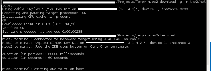

The screenshot is just to show the application is able to run with the chrono library.
Try to compile/build all even when you see the errors while editing the code.

It is a bit bit difficult to understand the solution just from this screenshot. Could you please explain in detail what exactly the solution is and how can I use the chrono library in NIOS II?
