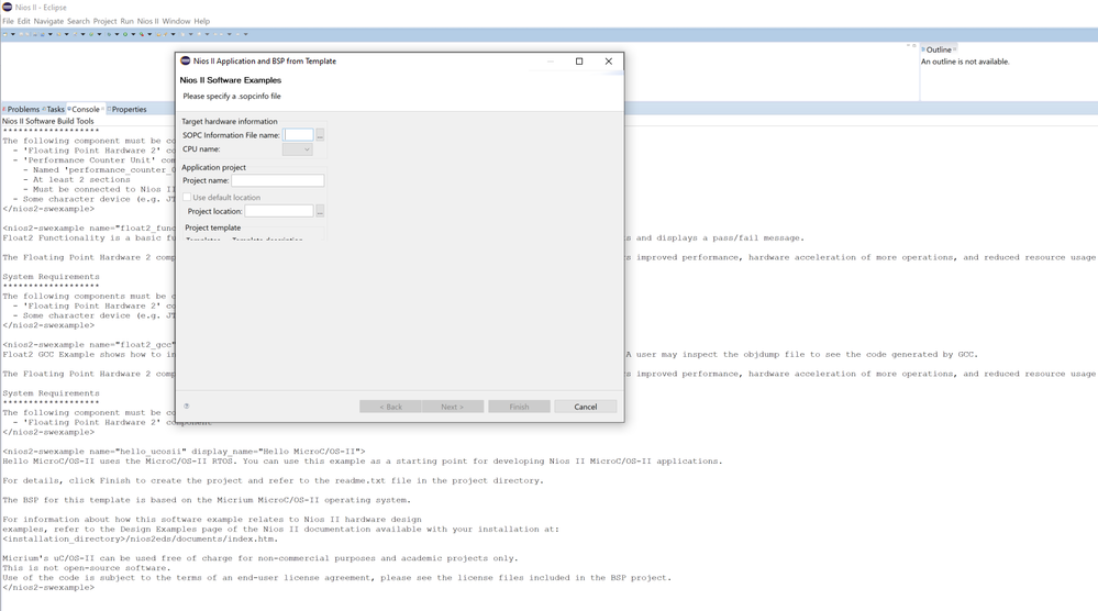

Problem with "New - Nios II Application and BSP from template".
The problem happened when I wanted to create "New - Nios II Application and BSP from template". My Quartus is 21.2 pro. I reinstalled WSL 1 and Ubuntu 18.04 LTS. But it still happened.
Dos anybody know how to solve this probrem?
