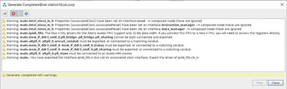

I have a project built in 22.1 Standard, that has a fifo with an 8 bit width:
I can read from my Nios V using the altera_avalon_fifo_read_level function, 1 byte at a time. Each time I call it the level drops by 1. It works as expected.
After I rebuild the project in 23.1 Standard, the altera_avalon_fifo_read_level function now reads 4 items at a time and returns a 32 bit int. The level drops by 4 each call.
There is a warning saying Nios II only supports 32-bit, and that you'll need to "access the registers directly". I don't know what that means.
I tried:
int sample = IORD_8DIRECT(IPMB_FIFO_OUT_BASE, ALTERA_AVALON_FIFO_DATA_REG);
While it returns 1 byte it also drops the level by 4.
How do I make 23.1 work like 22.1?
-Andy

    Is the design inspired by any online references?
    Could you share a screenshot of any warnings or errors that have popped up?

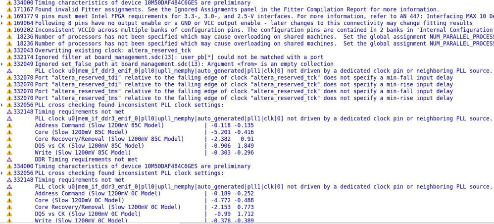

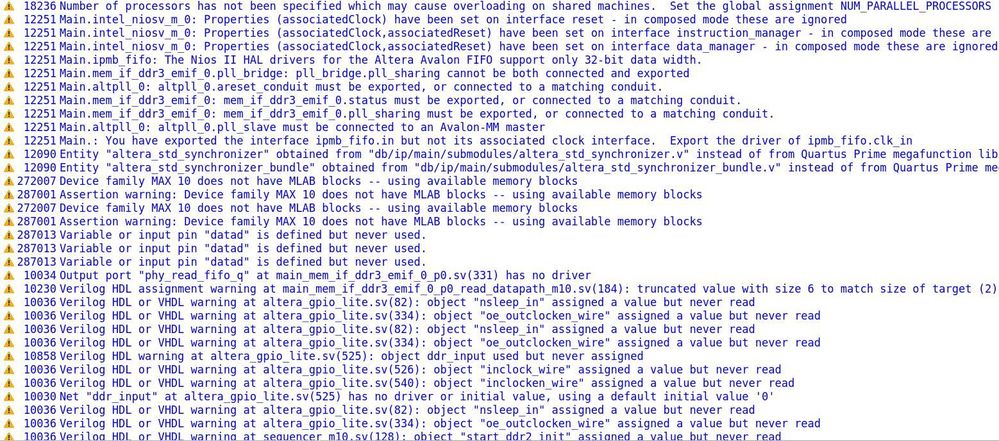

      Warning/errors: Sure. For version 22.1 or 23.1? I'll assume 23.1. For platform designer, quartus or gcc?
      I can also create an IPS ticket and share the entire project if that would be helpful.
      I'm using the Intel Max10 Dev Kit
      23.1 Platform Designer Generate:
      Quartus has 130 warnings, most are about alter_gio_lite.sv and DDR3 timing. (I have tried a number of different things to resolve the DDR timing and nothing works. But I get the errors on both 22 and 23 so I don't think that's the problem).
      Let me know how else I can help.

      • andy25's avatar
        andy25
        ... which is weird, because in this version of the project I've removed my use of gpio_lite. Not sure if something else is using it though. But I'm not intentionally using it anymore.
  • Hi,
    Can I know where is this warning appeared "There is a warning saying Nios II only supports 32-bit, and that you'll need to "access the registers directly" ?
    • andy25's avatar
      andy25
      Platform Designer. The first picture I posted. 4 messages down.
