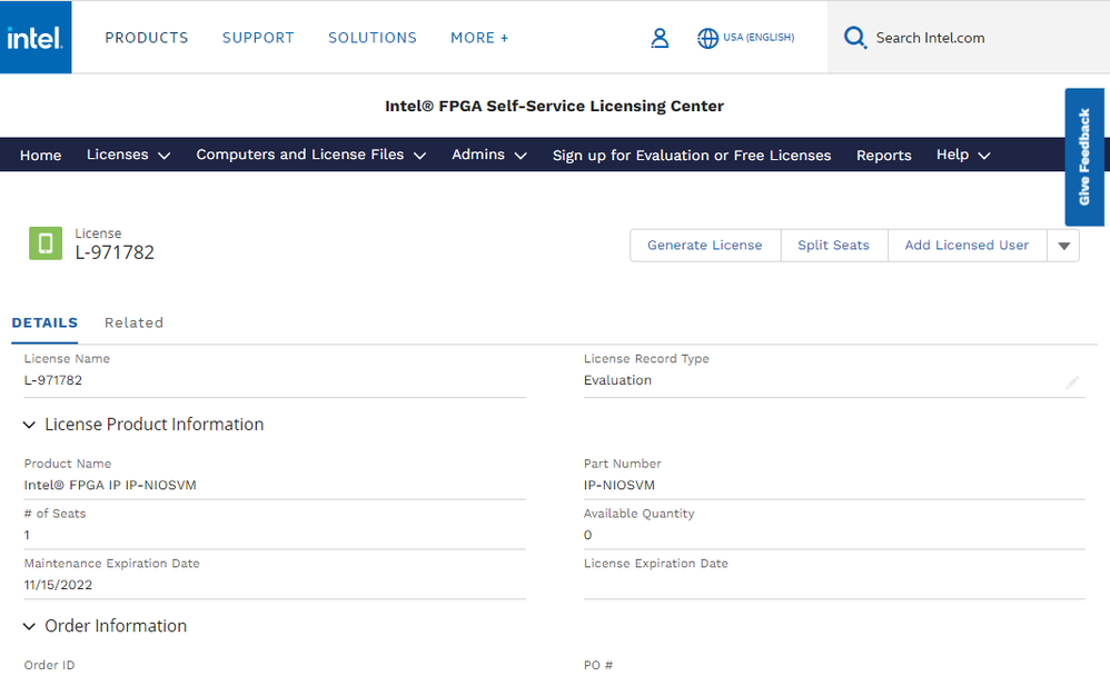

2. Obtaining a License
To use the Nios® V/m embedded processor, you need to acquire a free license. This section explains the procedure for obtaining a license. Additionally, we will also obtain a license for Questa*-Intel® FPGA Edition Software, used as a simulator.

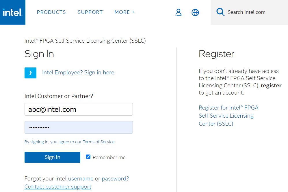

2.1 Sign In
Click on the Self Service Licensing Center. A Sign In screen like the one below will appear, so please sign in with your Intel account.
If you do not have an Intel account, please create one.

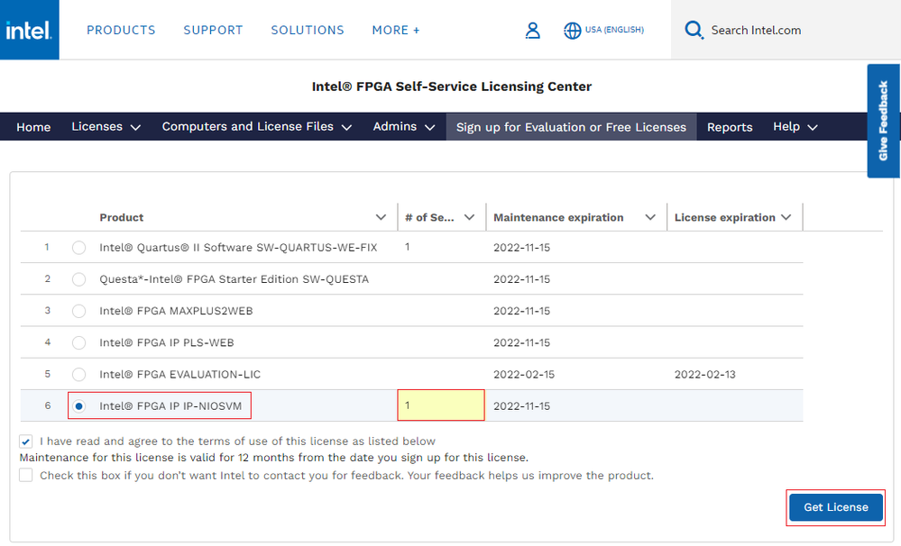

2.2 Obtaining a Nios® V/m Embedded Processor License
After signing in, the following screen will appear.
Select Intel® FPGA IP IP-NIOSVM, enter "1" in "# of Seats", and click "Get License" at the bottom right.

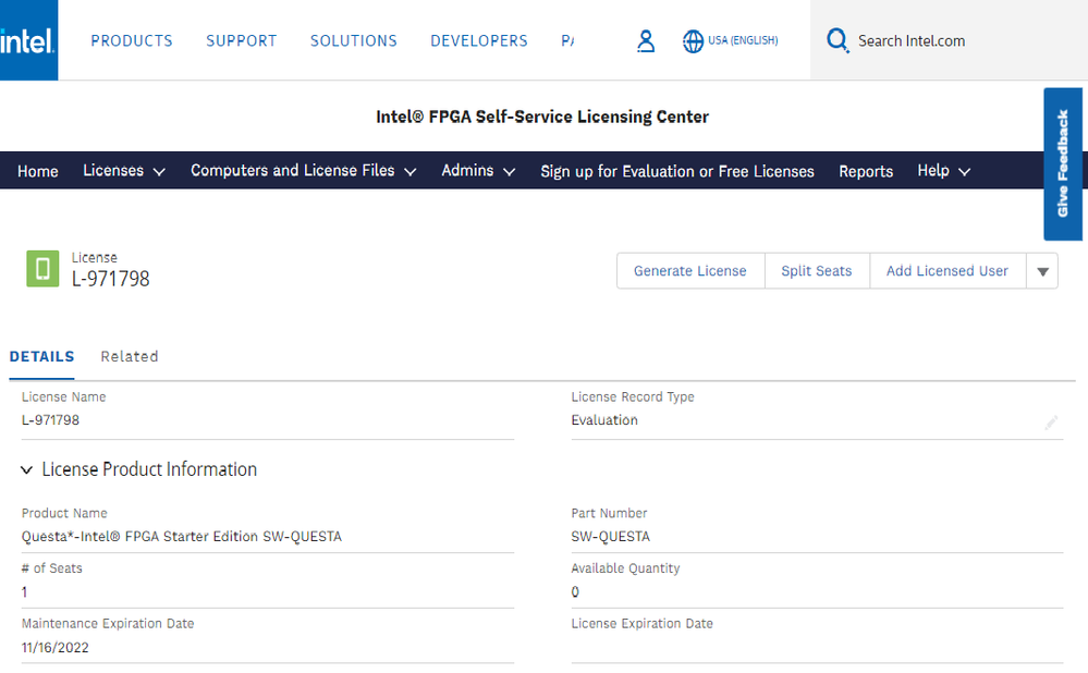

2.6 Obtaining a Questa*-Intel® FPGA Edition Software License
Follow the same procedure to obtain a license for Questa*-Intel® FPGA Edition Software. If you already have a license, proceed to the next chapter. As before, click on Self Service Licensing Center.
Select Questa*-Intel® FPGA Starter software Edition SW-QUESTA, enter "1" in "# of Seats", and click "Get License" at the bottom right.

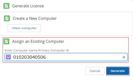

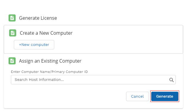

2.7 Adding to an Existing Computer
If the following screen appears, specify the PC you registered earlier by selecting "Assign an Existing Computer", enter the MAC ID, and press the "Generate" button at the bottom right.
2.8 Checking the Questa*-Intel®
FPGA Edition Software License File
Once generated, the following screen will appear, and the license file will be sent to the registered email address.
With this, the process of obtaining the license is complete.

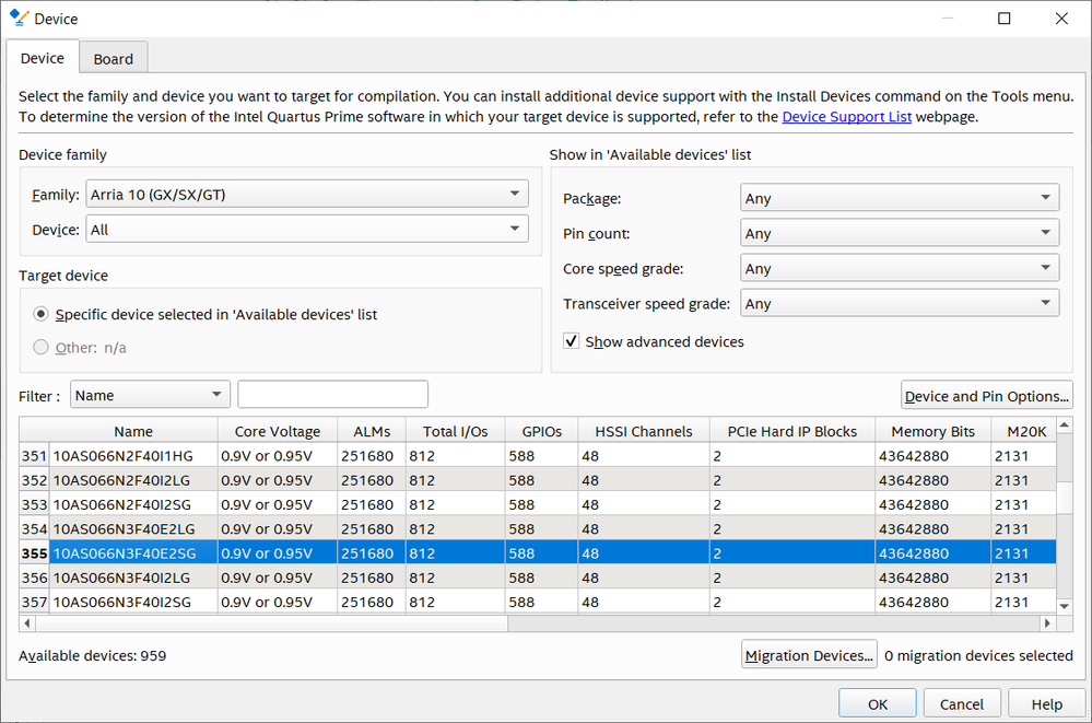

3.1 Installing Intel® Quartus® Prime Pro Edition 23.3

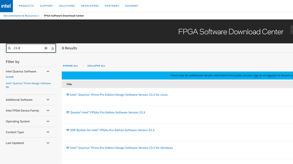

3.1.1 Download

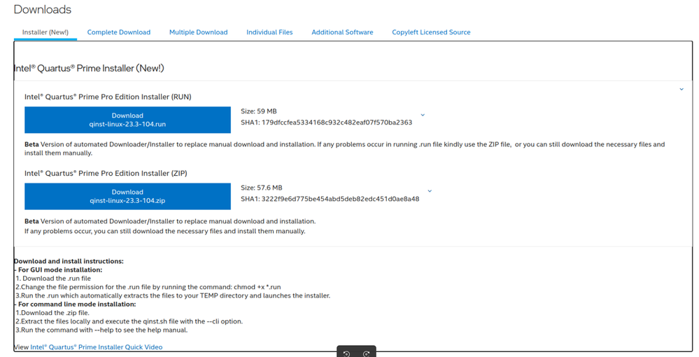

First, click on the FPGA Software Download Center and go to the page below. Follow the instructions for your OS to click on the corresponding version of Intel® Quartus® Prime Software. This explanation will cover installation on Linux.
Clicking will bring up the following page. Verify that the version is 23.3, then scroll down.
Download the Intel® Quartus® Prime Pro Edition Installer (RUN) from the page below. For Windows, download the Intel® Quartus® Prime Pro Edition Installer (EXE).
Once downloaded, enter the following commands in the download directory to launch the installer:
$ chmod +x *.run $ ./qinst-linux-23.3-104.run
For Windows, double-click the downloaded qint-windows-23.3-104.exe.

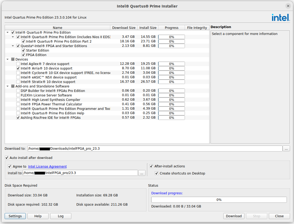

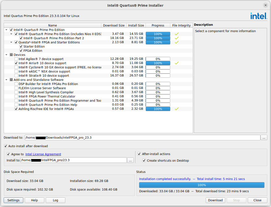

When the installer launches, select:
- Intel® Quartus® Prime Pro Edition Part 1 (includes Nios II EDS)
- Intel® Quartus® Prime Pro Edition Part 2
- Questa*-Intel® FPGA and Starter Editions
- Intel® Arria® 10 device support
- Ashling RiscFree IDE for Intel® FPGAs Check "Agree to Intel License Agreement" and click Download. If you wish to change the download or installation location, do so on this screen.

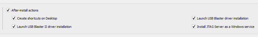

For Windows, ensure the following are checked under After-install actions:
- Launch USB Blaster driver installation
- Launch USB blaster II driver installation
- Install JTAG Server as a Windows service

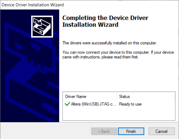

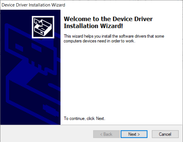

During download & installation on Windows, the Device Driver Installation Wizard will open for Intel® FPGA Download Cable II (formerly USB Blaster II) and Intel® FPGA Download Cable (formerly USB Blaster), which are necessary for FPGA configuration and debugging the Nios® V/m embedded processor. Please install them. For Linux, follow "1.6. Installing the Intel FPGA Download Cable II Driver on Linux Systems" in the Intel® FPGA Download Cable II User Guide.
Install the Intel® FPGA Download Cable (formerly USB Blaster) driver. Click Next.
Click Finish.
Install the Intel® FPGA Download Cable II (formerly USB Blaster II) driver. Click Next.
Click Finish.

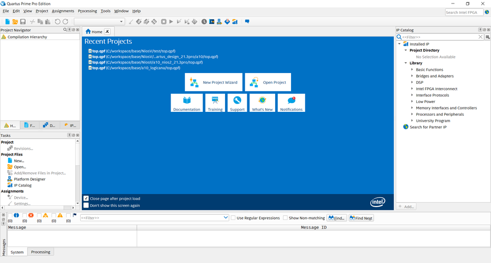

This is the screen after completing the Quartus installation.
With this, the installation of Intel® Quartus® Prime Pro Edition is complete.

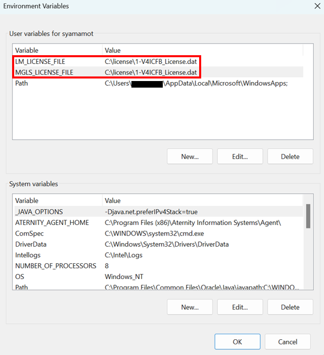

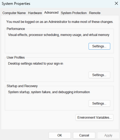

3.2.2 Windows

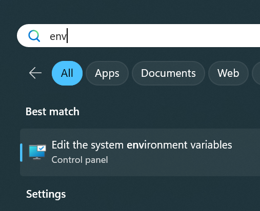

For Windows, use the Nios V Command Shell, so setting the tool paths is not necessary. Only specify the license. Press the Windows key on your keyboard and type "env".
Then select "Edit the system environment variables".
The following dialog opens, click on "Environment Variables".
In the User Environment Variables settings, as shown in the red frame, specify LM_LICENSE_FILE and MGLS_LICENSE_FILE to the license file. If there are multiple files, separate them with ";".
After restarting, the setup is complete.

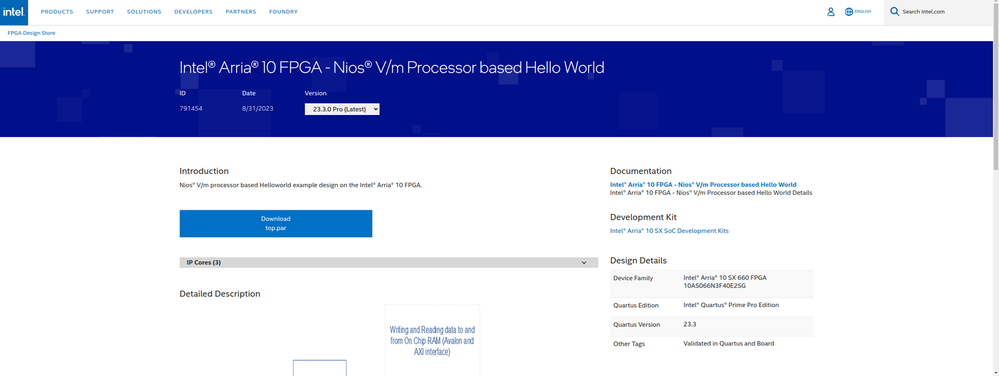

Here, we construct a design using the Nios® V/m embedded processor. Please download the Intel® Arria® 10 FPGA - Nios® V/m Processor based Hello World version 23.3 from the FPGA Design Store. The file name is top.par.
Once the download is complete, copy top.par to your work directory.

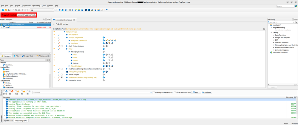

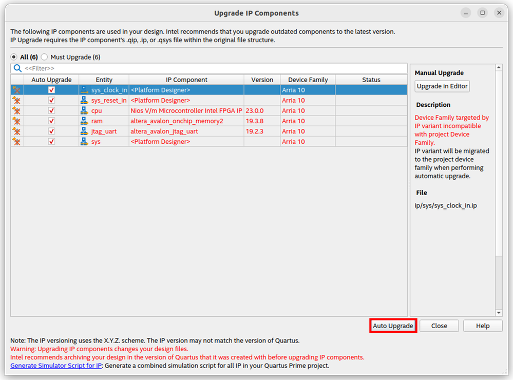

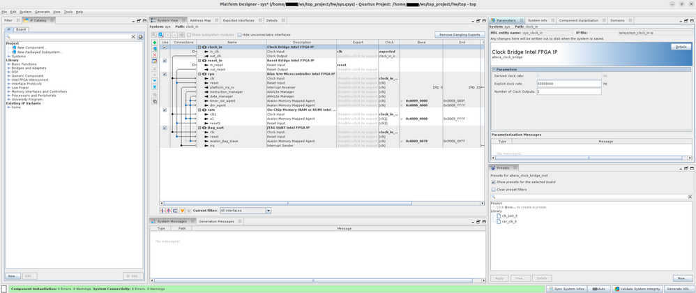

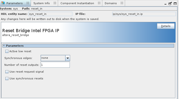

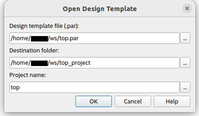

quartus top.par &
When Quartus launches, it will ask for the location to expand the Example Design. Specify your preferred work directory and click OK. From now on, we will proceed assuming the Example Design is expanded in $HOME/ws/top_project for Linux and C:/ws/top_project for Windows. All terminal commands should be executed from $HOME/ws/top_project or C:/ws/top_project.

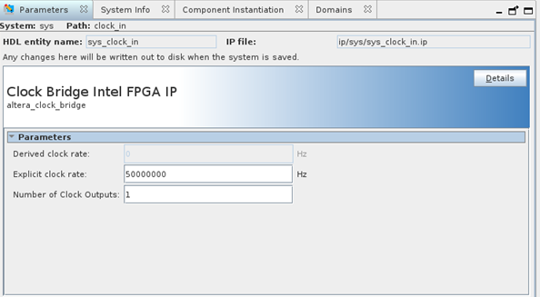

As you can see in $HOME/ws/top_project/hw/top.v, this design uses only one 50MHz clock input, making it easy to port to other FPGAs. For more details, see 4.5 Porting to Other FPGAs. For the reset, we use an IP that controls signals from JTAG called ISSP (In-System Source & Probe) and perform the reset with toggle_issp.tcl. For more details, see 5.1.6 CPU Reset by ISSP (In-System Source & Probe).

As a premise, the Example Design just downloaded and expanded is in a ready-to-test state, meaning all files and binaries required for running the Nios® V/m embedded processor are already included. The FPGA configuration file is at $HOME/ws/top_project/ready_to_test/top.sof, and the ELF files for the Nios® V/m embedded processor application are at $HOME/ws/top_project/ready_to_test/app_hal.elf, $HOME/ws/top_project/ready_to_test/app_ucosii.elf, $HOME/ws/top_project/ready_to_test/app_freertos.elf. Use these for testing on actual hardware. The following will explain the steps for compiling the hardware design and building the application for the Nios® V/m embedded processor.

Let's check the Platform Designer design in the GUI. There are two ways to launch Platform Designer: one is to launch it from the Intel® Quartus® Prime software, and the other is to launch it via command from the Terminal.
4.2.1 Launching Platform Designer from Intel® Quartus® Prime Software
- Execute the following in the Terminal to launch Quartus:
quartus &
For Windows, you can also launch Quartus from the Start menu by selecting Quartus Prime Pro Edition 23.3.0.104 -> Quartus (Quartus Prime Pro 23.3).

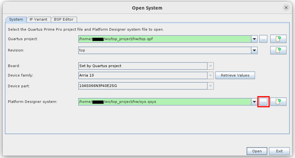

From the File menu, select "Open Project..." and specify $HOME/ws/top_project/hw/top.qpf, then click "Open".
From the Tools menu, select "Platform Designer".
In the "Open System" dialog that appears, click the red frame and specify the $HOME/ws/top_project/hw/sys.qsys file.
- Click Open.
4.2.2 Launching Platform Designer from Terminal
Move to $HOME/ws/top_project and enter the following command:
qsys-edit --quartus-project=hw/top.qpf hw/sys.qsys
4.2.3 Platform Designer Design
Here, we'll check the design configuration and settings for each IP. The following is the overall design configuration:
4.2.3.1 Clock
This is the configuration screen for the clock input IP. If the input clock differs, change this value. If you change it, also modify the clock period in top.sdc (period is specified in ns).
For IP details, please refer to 7.1.1. Clock Bridge Intel® FPGA IP.
4.2.3.2 Reset
This is the configuration screen for the reset input IP.
For IP details, refer to 6.6.3. Reset Bridge.

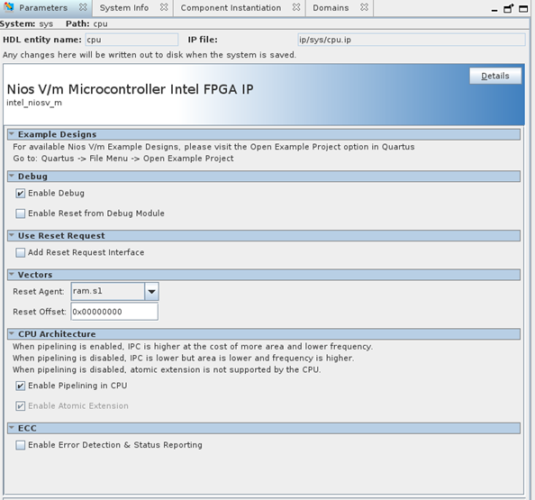

4.2.3.3 Nios® V/m Embedded Processor
This is the configuration screen for the Nios® V/m embedded processor IP.
For details on each parameter, refer to the following:
- 2.1.1.2.1. Debug Tab
- 2.1.1.2.2. Use Reset Request Tab
- 2.1.1.2.3. Vectors Tab
- 2.1.1.2.4. CPU Architecture
- 2.1.1.2.5. ECC Tab

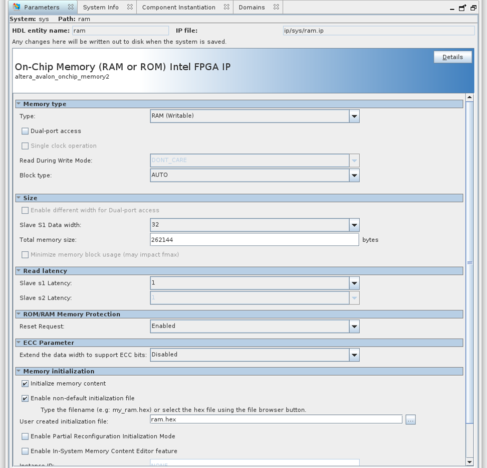

4.2.3.4 Internal RAM
This is the configuration screen for the internal RAM IP.
- 25.2.1. Memory Type
- 25.2.2. Size
- 25.2.3. Read Latency
- 25.2.4. ROM/RAM Memory Protection
- 25.2.5. ECC Parameter

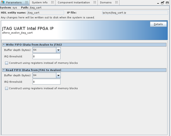

4.2.3.5 JTAG UART
This is the configuration screen for the JTAG UART IP.
Once you have confirmed the settings, please close Platform Designer.
If you are porting this design to other FPGA boards, the main changes will be the device and clock pins.
- From the Assignments menu, select "Device..." and in the dialog that appears, specify the device you are using.
- Once the device is changed, Quartus will display "IP update required" in red at the top left. Click "Launch IP Upgrade Tool...".
- In the dialog that appears, click "Auto Upgrade" to update the IP.
- Once the IP update is complete and the Status column shows "Success," you can close the dialog.
- From the Processing menu, select “Start Compilation..." to re-run the compilation. You may encounter errors in the Fitter stage if you haven't set up the clock pin, but you can ignore these for now.
- From the Assignments menu, select "Pin Planner..." and in the dialog that appears, update the location of the clock pin. Also, update the I/O Standard accordingly.
- Finally, from the Processing menu, select “Start Compilation..." again and ensure that the compilation runs without errors this time.
