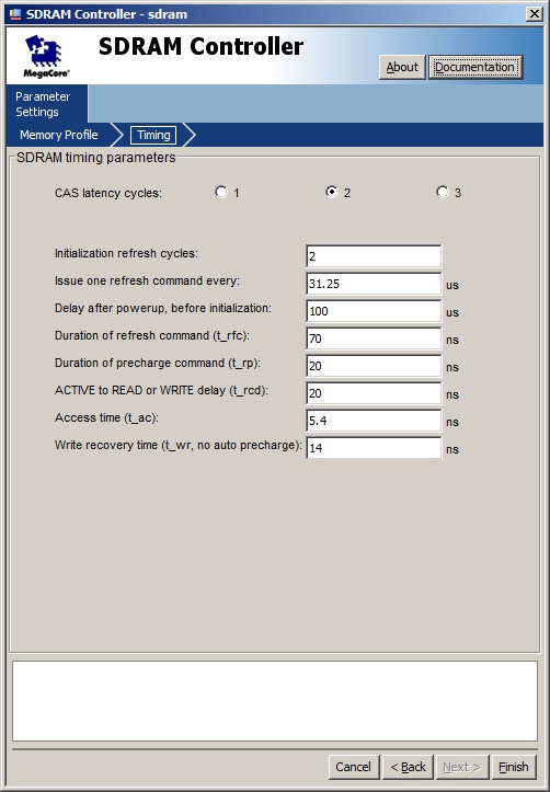

I have a problem in my nios II simulation. I have used the avalon memory-mapped master template for writting into a sdram memory. When I simulate the component and the master_write signal is asserted, the master_waitrequest signal reminds in a high level for 143350 ns, which is too long time....
I have upload the sdram parameters.

    OK I will try to answer myself, until 200000ns the sdram is not initialized by nios. After this time the waitrequest signal is reduced to 143ns.

    That memory controller is not initialized/calibrated by Nios II, that is the old SDR SDRAM controller. Just like the newer DDR SDRAM controllers there is some time spend while the controller is coming up out of reset where it can't perform data accesses off-chip and as a result wait request must be asserted. I can't remember how long that delay is but 143us sounds about right.
