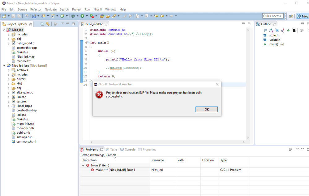

I Can not run my Nios II program, because of "Project does not have an ELF file"
Hello,friends
there is a problem when i used Nios II, "project does not have an ELF file, Please make sure project has been built successfully",
Do anyone kown this issue?

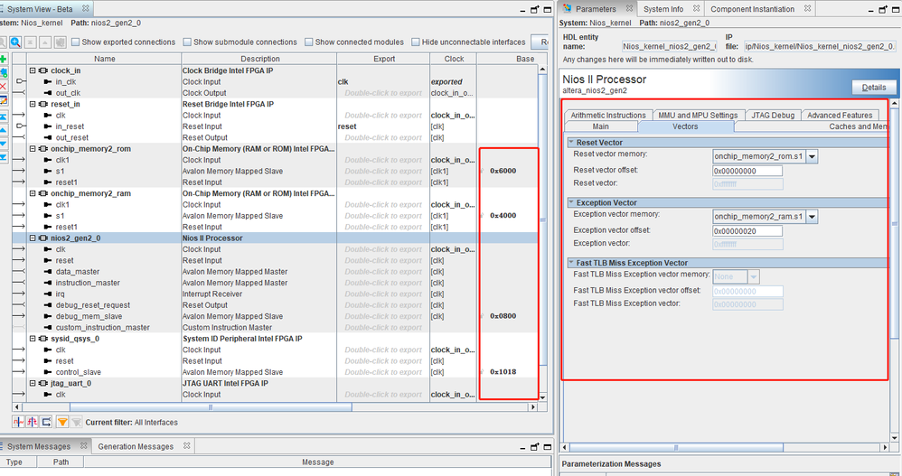

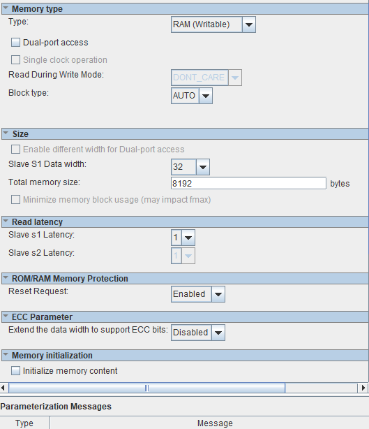

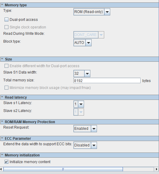

What is the size for your on-chip memory that been vectored as reset memory and exception memory? if it is not an on-chip memory please let me know. It is mainly the size isn't enough or the bsp setting isn't the correct setting for the chosen memory.
- FZhan39
It is on chip memory,and the size as following:
RAM on chip is 8192bytes
ROM on chip is 8192bytes
I tried to set the size of RAM and ROM is 4096bytes, but the issue is still..
