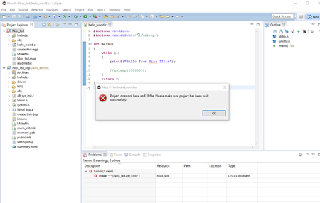

7 years agoI Can not run my Nios II program, because of "Project does not have an ELF file"
Hello,friends there is a problem when i used Nios II, "project does not have an ELF file, Please make sure project has been built successfully", Do anyone kown this issue? Thanks

8192 Bytes is small for an application, please let me know what device family you are using? I normally start with 64000 Bytes and see if the application will fit or not.
FZhan39
7 years agoThe FPGA is Cyclone 10, I have solved the issue by increasing the RAM.
Thank you so much!
