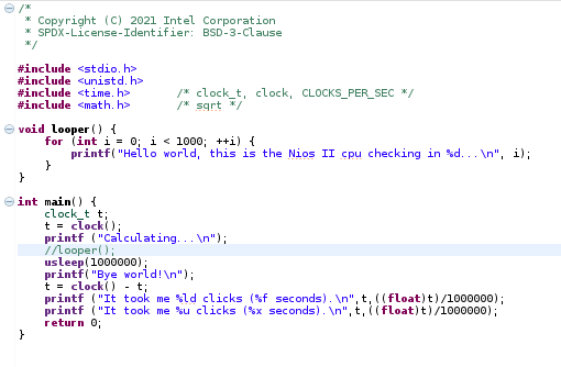

How to calculate the time for running the code in Nios II and Nios V?
How do I calculate the time used for executing a command in Nios II and Nios V.
I was using the example in the below link but the results from Nios II and Nios V are different.
https://cplusplus.com/reference/ctime/clock/
clock_t t;
t = clock();
printf ("Calculating...\n");
... (Anything, or you may put usleep (1000000)
t = clock() - t;
printf ("It took me %ld clicks (%f seconds).\n",t,((float)t)/1000000);
printf ("It took me %u clicks (%x seconds).\n",t,((float)t)/1000000);
Nios II
Nios V
Could you share the way to calculate the time taken for running a piece of code in Nios V?

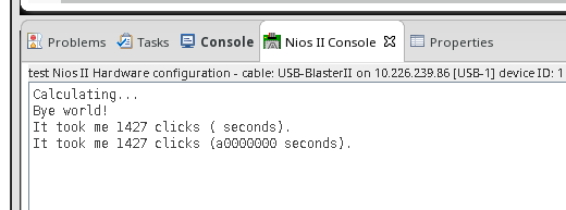

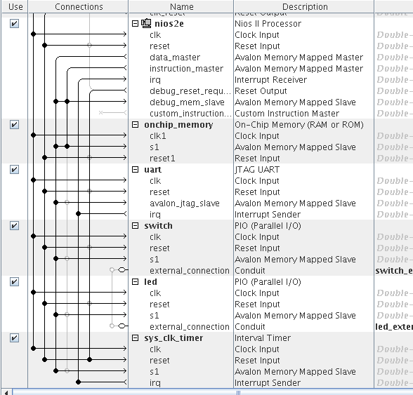

    I tested the MAX 10 Nios II Hello World example in Intel FPGA Design Store. I found out for Nios II Interval Timer needs to be added in order to get accurate and valid execution time calculation. Also in BSP Editor, set the sys_clk_timer check image below:
    The execution time of Nios II for running code without looper is 1427 clicks which is close to Nios V execution time of 997 clicks.
