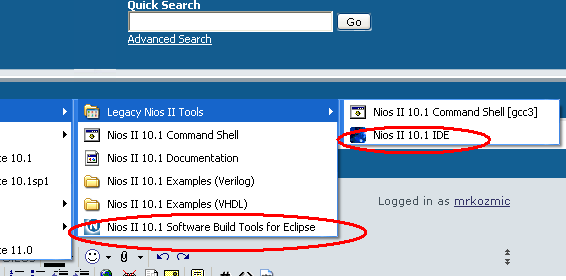

--- Quote Start --- So that others know you'll also have to install the legacy Nios II tools from the Altera installer. In 11.0 I believe this is enabled by default but you do have the option to turn it off. If you turn it off the installer will not install the IDE or C2H to your drive. --- Quote End --- How to option C2H compiler and turn it on? My Nios II SBT for eclipse is 10.1 sp1, But I don't found the"Accelerate with the Nios II C2H Compiler". Thanks. - Altera_Forum
Honored Contributor
--- Quote Start --- How to option C2H compiler and turn it on? My Nios II SBT for eclipse is 10.1 sp1, But I don't found the"Accelerate with the Nios II C2H Compiler". Thanks. --- Quote End --- You have to run the Legacy NIOS II IDE, not the NIOS II SBT for Eclipse. Also, I think you have to right-click on the function name in the source code. Hope this helps. In my case, I can find the "Accelerate with the Nios II C2H Compiler" option but it just does not work. Nothing happens when I click it. Please try and tell about your experience - Altera_Forum

Mrkozmic is correct, C2H has never been supported in the software build tools for Eclipse tools. You have to install the legacy tools which comes with the Nios II IDE which C2H is available from.
