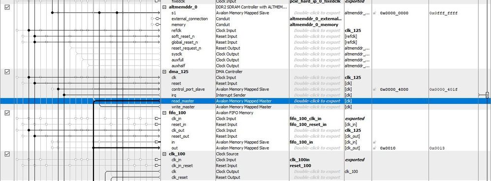

Thank you for your answer. What is wrong with my design? I want to transfer 100 Msps 14 bit ADC continuous data to DDR2 SDRAM using DMA. Is there any issue with the Qsys design below? Anybody please take me out of this hell because I am about to freak out!!
