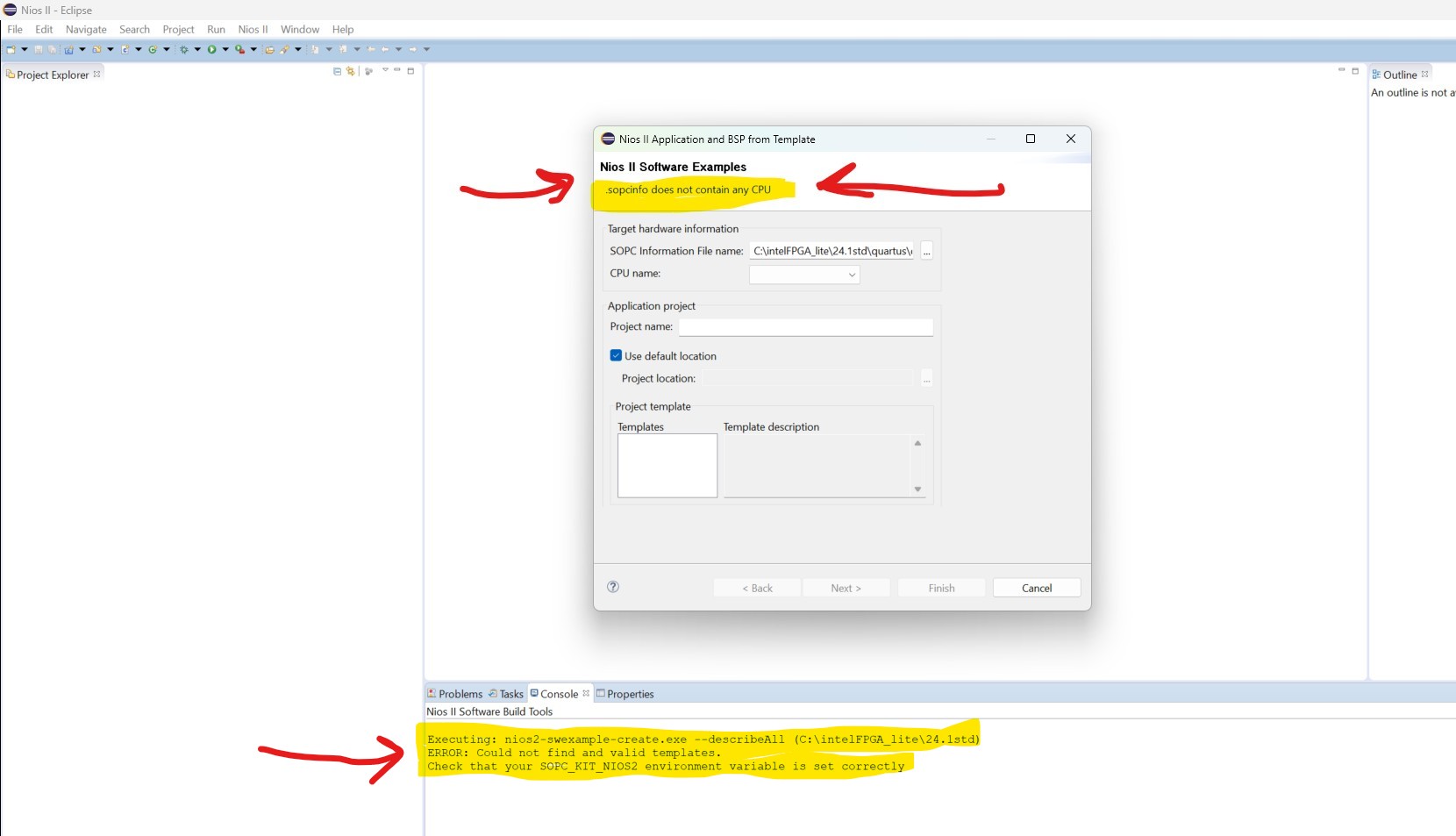

I am trying to create bsp and software for Nios V , using Eclipse IDE. When specifying a new projcet and its .sopc file i see message CPU not detected. And i also see message the NIOS_EDS environment variable not set.
See screen shot attached . I verified via command prompt the environment variable is set and can be verified. Also i noticed there are no examples installed at this path :
C:\intelFPGA_lite\24.1std\nios2eds
Looking forward to resolve these issues, Thanks,
For Nios V in Quartus Standard, you will be using the "niosv-bsp-editor" to generate the BSP, and Ashling RiscFree IDE to build the project.
(Nios II Eclipse IDE is not enabled to support Nios V.)You may refer to the Max 10 Nios V project example here.
