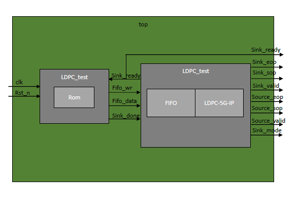

      LDPC IP in my hardware has been verified in Modelsim, and the simulation has been successfully compared with MATLAB. Only when it is verified in FPGA, it is found that the sink ready signal is low. When I added the input and output signals to HDL for verification, I connected them to the pin except for the sink [data]. I found that in post fit, the compiler automatically connected the signals to GND. I confirm that my reset signal is normal. The signals about LDPC are all 0

    I used the Intel arria 10 GX official development board and wrote a new piece of code at home due to our illness. Attached is my engineering document.
    I find that many internal signals of LDPC ﹣ 5g IP are optimized.
    quartus prime pro 19.1​
    • CheepinC_altera's avatar
      CheepinC_altera
      Hi, Thanks for your update. I have run compilation with your design in Q19.4Pro which was currently available in my local PC. As I checked the RTL viewer, post-mapping and post-fitting, I can see that the important signals ie data, clock, sink_sop/eop are still available. Just wonder if you are seeing the same as following: [cid:[email protected]] By the way, for testing purpose, just wonder if you have had a chance to create simple design with only 5G LDPC IP instance. Then feed dummy fix data and direct clock signal from oscillator. Just to check if after releasing reset, will the sink_ready go high. From the simulation and user guide, with clock and reset correctly, the sink_ready should be able to assert. Thank you. Best regards, Chee Pin
