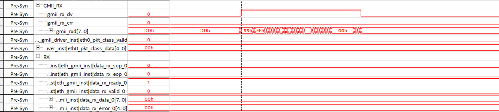

When I send a UDP Broadcast packet from the PC to the board, the packet is
visible on the GMII RX lines coming from PHY (see figure below). But data do not (or only sporadically) arrive on the Avalon-ST RX bus (see illustration) .
What could be the reason for this?

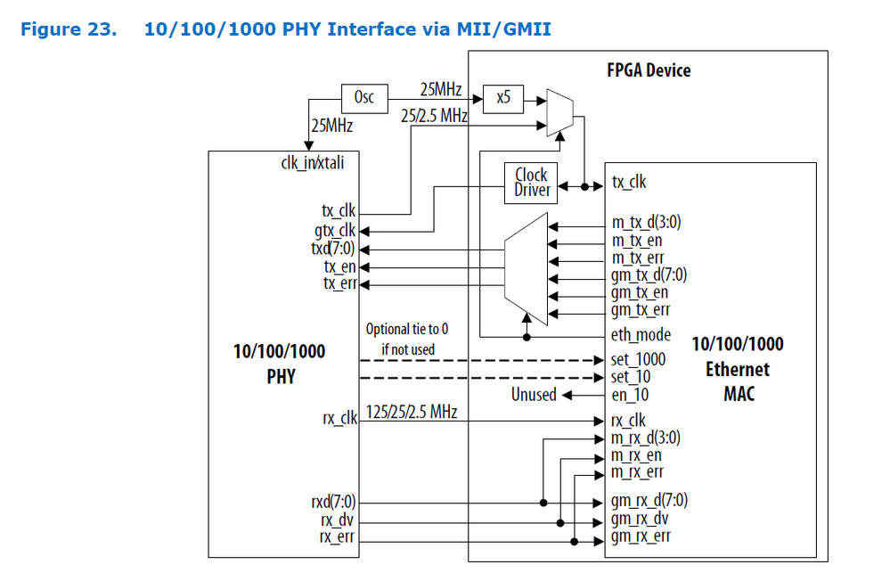

I have connected the TSE mac according to this illustration.

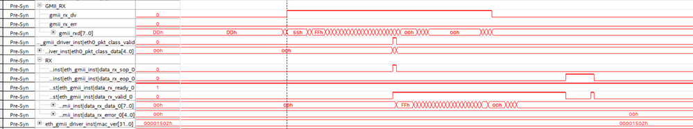

In the rare cases where the data received via GMII arrives on the Avalon-ST RX bus, it looks like this:
This is it should always look like!
