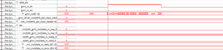

Dear Community, I am using the Triple Speed Ethernet IP Core with the GMII interface on a board with a Cyclone 10GX220. The TSE MAC command register was initialised with: 0x2033 (SW Reset, Pad E...

Wasn't a timing problem. It was a evaluation dialogue window problem:
community.intel.com/t5/FPGA-Intellectual-Property/Triple-Speed-Ethernet-MII-GMII-Timing-Issue/m-p/1531419#M28109

2 years agoIn the meantime i think it is a timing problem.
I will open a new post for this.
