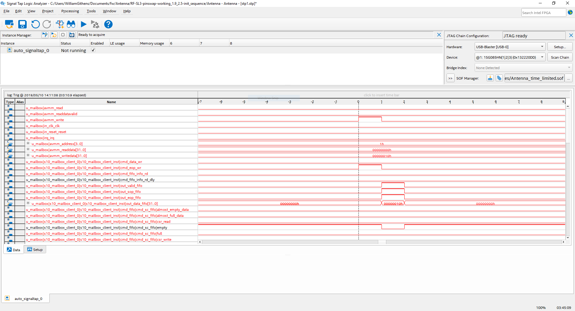

    Here is a couple of signal tap captures. The Write IDCODE is the writing of 0x10. As you can see it enters the fifo and then continues on. I don't see a response though.

    This is the second half of the previous signaltap. This shows the command being read out of the fifo and heading to the SDM.

    Here is the signaltap showing that reading the ISR is always 0x2h
