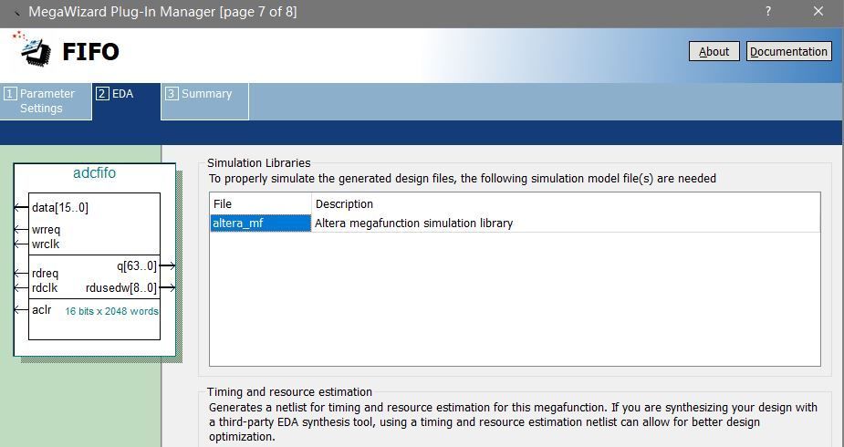

It can not be successfully simulated in modelsim-intel. Based on IP, it requires altera_mf.
This is already in modelsim searched libraries. So I don't know why it still fails.
The error message is as below. adcfifo is qip I generated based on Intel FIFO IP.

      Yes, the adcfifo.v is in the qip files. Actually I already include qip in below two methods, but it still doesn't work.
      1) add qip through assignment - > setting - > files
      2) add qip in platform designer -> component editor -> files -> both synthese file and simulation files.
