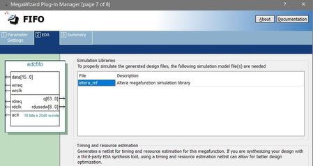

Problems when using FIFO IP for simulation
adc_fifo.v(41): Instantiation of 'adcfifo' failed. The design unit was not found.

Modelsim can't find the so-called adcfifo.v file and I guess the adcfifo.v is in the adcfifo.qip that you generated based on Intel FIFO IP. Add the qip in your project, compile and simulate again.

Yes, the adcfifo.v is in the qip files. Actually I already include qip in below two methods, but it still doesn't work.
1) add qip through assignment - > setting - > files
2) add qip in platform designer -> component editor -> files -> both synthese file and simulation files.

I just solved the issue by adding adcfifo.v in the component editor simulation files.
1) Add adcfifo.v --> it works.
2) Add adcfifo.qip --> it doesn't work.
