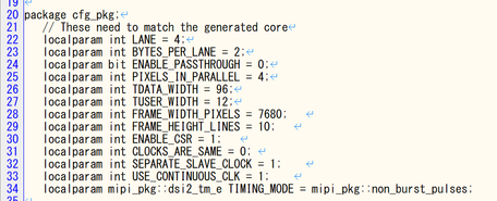

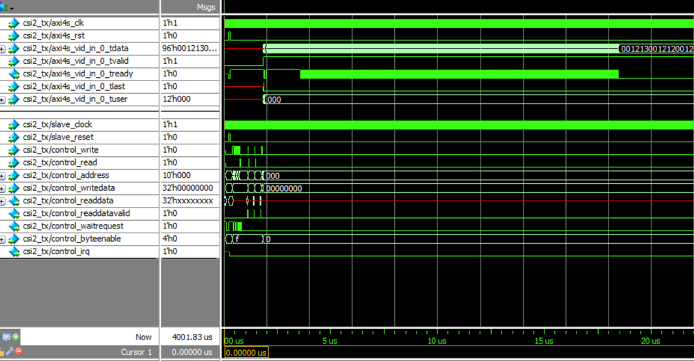

Hi, I am using Quartus ver 26.1 PRO Edition and investigating the MIPI CSI-2 TX IP on Agilex 5 E.  I generated the CSI-2 Example Design and am running a RTL simulation. To change the video width, I modified the setting of FRAME_WIDTH_PIXELS in cfg_pkg.sv. When FRAME_WIDTH_PIXELS = 3840, the operation is normal. However, when FRAME_WIDTH_PIXELS = 7680, tready goes low and the system stalls. Is there an upper limit for FRAME_WIDTH_PIXELS?

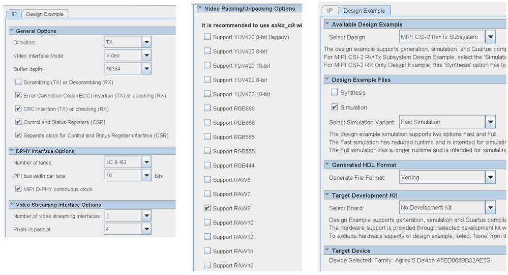

The IP setting is follow:

    In RAW8 each pixel has 8 bits, which in the VVP streaming protocol is carried using 16-bits per pixel.
    So 4-PIP RAW8 requires a 64-bit wide data bus.  But the cfg_pkg image and waveforms show a 96-bit data bus, which at 4 PIP implies 24-bits per pixel. Unfortunately, the image of cfg_pkg was cropped to hide the data type.  For example, ours for the above was:
    Can I get your IP configuration(maybe a screenshot on the setting related to data type that you are using)./.qar will be better
    so that we can replicate your setup and continue to investigate?

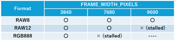

      Hi Wincent,
      I apologize for the confusion. The data I previously attached was actually the result for RGB888. After changing the image format and frame width, I obtained the results shown in the table below. I have also attached the design that was used.
      It appears that there may be some kind of upper limit.

      IF not , do appreciate if you can help to provide the IP configuration, and especially the data type that you are using,

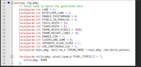

      I've had problems getting the sim to run in that config, as the sim wasn't really designed to handle such long lines, it was only intended to demonstrate data flow I believe.  As I can see a simple way to fix the main place it struggles.  However, I don't see the issue that you reporting in that configuration - I can get 7680 pixel lines through CSI Tx in the stated configuration without seeing the input stall.
      In RAW8 each pixel has 8 bits, which in the VVP streaming protocol is carried using 16-bits per pixel.  So 4-PIP RAW8 requires a 64-bit wide data bus.  But the cfg_pkg image and waveforms show a 96-bit data bus, which at 4 PIP implies 24-bits per pixel.  Unfortunately, the image of cfg_pkg was cropped to hide the data type.  For example, mine for the above was:

    Hi Wincent,
    Thank you for your reply.
    I ran simulations for RAW8, RAW12, and RGB888 and obtained the following results. The testbenches for each case are included in the ZIP file I previously attached.
    Similar to your results, RAW8 worked correctly even at 9600, but RAW12 failed at 9600.
    Is there any way to make RAW12 also pass at 9600? Or is the maximum supported value fixed by the IP specification, with no available workaround?
