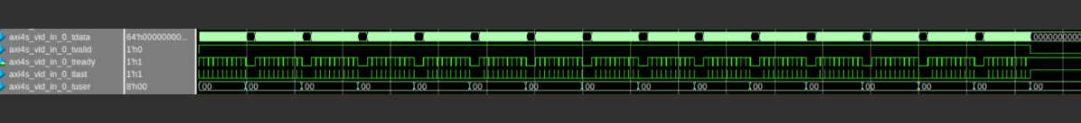

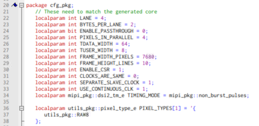

I've had problems getting the sim to run in that config, as the sim wasn't really designed to handle such long lines, it was only intended to demonstrate data flow I believe. As I can see a simple way to fix the main place it struggles. However, I don't see the issue that you reporting in that configuration - I can get 7680 pixel lines through CSI Tx in the stated configuration without seeing the input stall.
In RAW8 each pixel has 8 bits, which in the VVP streaming protocol is carried using 16-bits per pixel. So 4-PIP RAW8 requires a 64-bit wide data bus. But the cfg_pkg image and waveforms show a 96-bit data bus, which at 4 PIP implies 24-bits per pixel. Unfortunately, the image of cfg_pkg was cropped to hide the data type. For example, mine for the above was:
