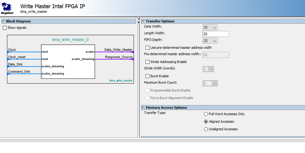

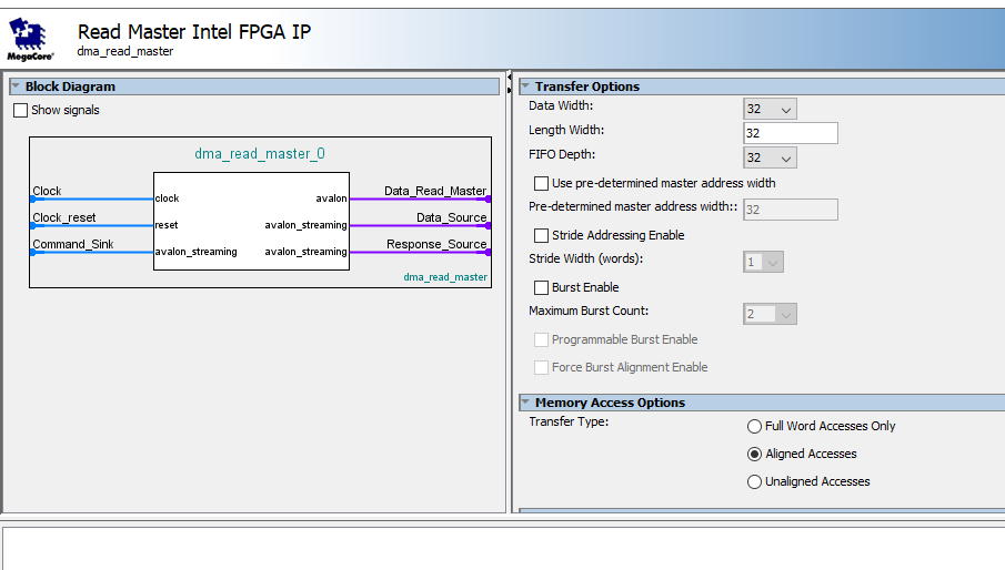

The MSGDMA is deliberately designed to be modular.
As such , if I wanted to utilise the Read and Write Master IP without the Dispatcher, there is no published specification for the Command and Response Ports.
Why is that? Are we forced to use the Dispatcher with a Host port or can we use the FPGA fabric to interface with the Command and Response Ports directly assuming there is a specifcation for them somewhere?

- Device/development kit details used? -MAX 10: 10M40DAF256I6G
- are you using any GHRD or GSRD for this? -No
- Is this about the PCIe, MSGDMA and the PC Host driver? -Its about the Command and Response Ports of the below.
There is zero information on them apart from telling me to use them with the Dispatcher which I dont want to do.
I want to add my own Controller. So details please!
