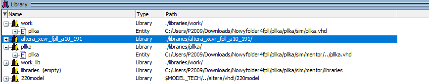

Previosly i created .tcl script in sim/mentor directory:
set QSYS_SIMDIR ../
source $QSYS_SIMDIR/mentor/msim_setup.tcl
dev_com
com
and i typed do <name of my tcl> in console of modelsim. Libraries was succesfully added.:
then i compiling component in sim direcotry, clicking on work-pll i and i get error mentioned above. I am using Quartus Pro 21.2.0.72. Cyclone 10GX project.
