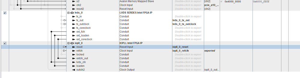

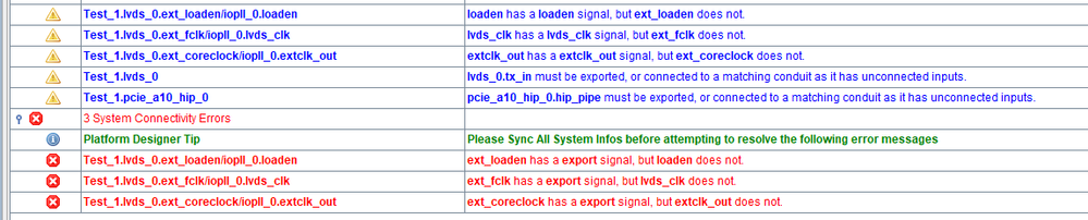

I am using the LVDS SERDES IP with external PLL provided by the IOPLL. I configured the IOPLL as recommended in the LVDS SERDES IP for Cyclone 10 GX but I am getting an error:
"ext_<clock name> has a export signal, but <clock name> does not."
This is true for all three clock input from the IOPLL to the LVDS SERDES.
Any idea on how to fix this?

      Hi JonWay,
      Yes I tried both options for the "Access to PLL LVDS_CLK/LOADEN output port": <"LOADEN 0" and "LOADEN 0 & 1">.
      So you want to export these signals and connect them within a module?
