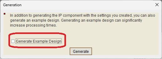

      • Hidetaka's avatar
        Hidetaka
        Hello, Adzim-san.
        sstrell-san.
        When I saw the error message, the error was in the "Info: LPDDR2_top2: Generating example design" item,
        so I thought maybe I just shouldn't generate the example design, so I ran it, and it was generated without any errors.
        Error: Execution of script "/0008_LPDDR2_top2_gen/simulation/generate_sim_example_design.tcl" is causing an error, so I would appreciate it if you could fix this part.
