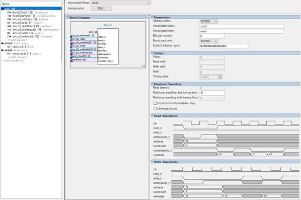

i just finish read Avalon mm Interface Spec Sheet . and i tried to make it.

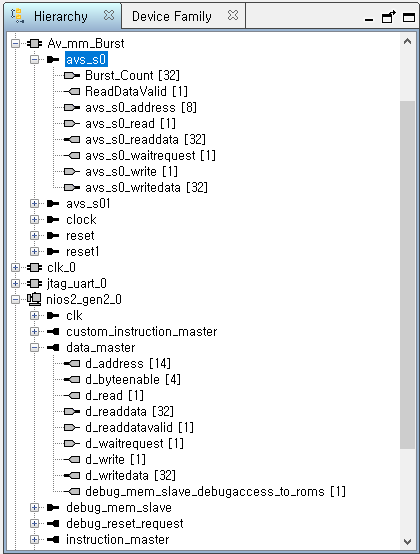

1. I Dened like that Nios..

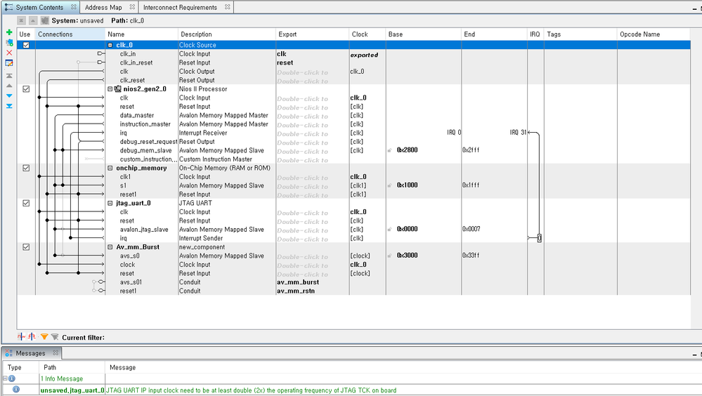

2. Nios Connection

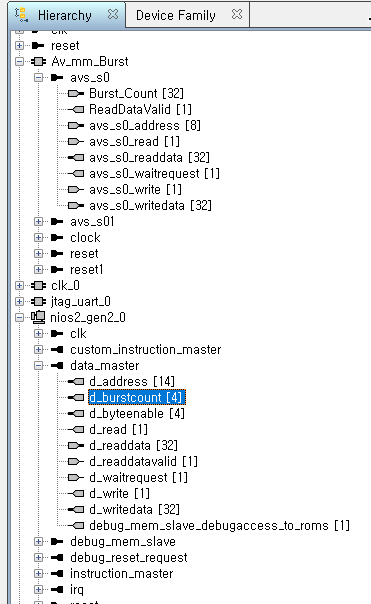

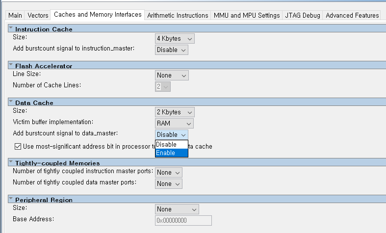

when Connection Initial Nios Core Settings don't have Burst Count [32] so i tried to make it
- nios → Caches and Memory Interfaces → Data Cache → Add Burstcount signal to data_master → Enable
- Avalon MM -Slave <----> NIOS Core Data Master
: Burst_Count [32] <-----> : none
: ReadDataValid [1] <-----> : ReadDataValid [1]
: Addr [8] <----> : Addr [14]
: Read [1] <----> : Read [1]
: Read_Data[32] <----> : Read_Data[32]
: wait_Request [1] <----> : wait_Request [1]
: write [1] <----->: write [1]
: Write_Data [32] <----->: Write_Data [32]
: none <-----> : Byte_Enable [4]
: none <----> : debug_mem_slave_debugaccess_to_roms [1]
for burst transfer is it good connection?
