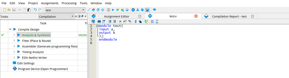

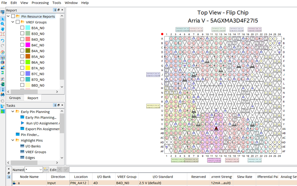

      Another question related to this table... How do we invoke the 'optional function' on a pin, for example the VREFB4DN0 on pin AA12. I understand this should be an externally supplied reference voltage for bank 4D at 1/2 the selected IO standard for the bank, but the pin also seems to serve as an IO pin. Do we need to configure the pin to use it as a voltage reference input?
      • NurAida_A_Intel's avatar
        NurAida_A_Intel
        Hi KMich2,
        Depending on your design, if you used verilog code then you can set the input pin in your RTL ( as shown in Figure 1) , re-compile the design ( compile at Analysis and Synthesis stage will do) and assign this PIN_AA12 as input in your Pin Planner (Figure 2). Then directly connect the VREF to this PIN_AA12. Make sure also the I/O standard is set accordingly with your design. What shown in Figure below is just an example for your reference. 😊
        Figure 1:
        Figure 2:
        If you are using the Qsys, then set the input in Qsys.
        Hope this helps.
        NAli1
