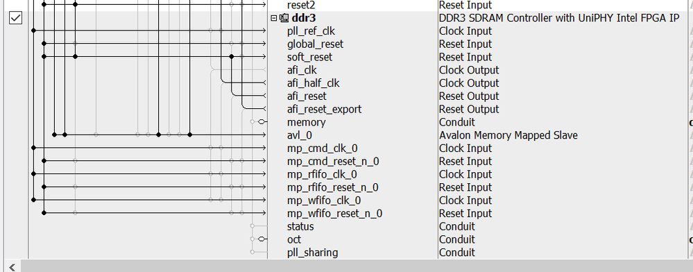

I have created on qsys design which contains NIOS II processor + ddr3 + other ips+ custom logic in cyclone v gx device.
with this I tried to compile the design in quartus 22.1 tool, i am facing 17044 error.
If the error is for Custom RTL , i can modify the io connection. But the error is throwing ddr3 ip library file connected in qsys. Even i tried one of the solution shared in intel forum that make qsys file as top file. And observed no error for qsys top file. But if i make bdf file as top, i am getting this error.

Yes, I have checked the top-level design (BDF file). that is matched with ip file.
I am using quartus 22.1.2 std version tool.
I have implemented Nios II processor + mm bridge+ ddr3 ip + TSE ip + custom logic in qsys and generated the qsys files without any errors.
After qsys generation, added the updated bsf file in top bdf file and started compiling the process.
While running analysis and synthesis, 17044 error (io buffer primitive) reported for ddr3 ip library file connection.
We even tried with soft ddr3 ip / hard ddr3 ip to reolve this issue. But for both i am getting the error.
