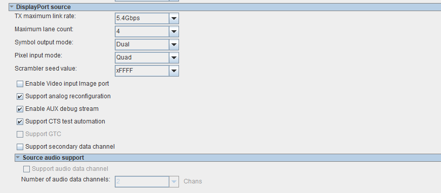

hi,
I am working in display port IP and there is an option mentioned related to CTS.
Is this option is related to test automation mentioned in display port specification or only for generation of CRC values of different color components.

    Hi @number_7,
    Yes, this option is related to the test automation mentioned in the DisplayPort specification. To perform the CTS for DisplayPort, this option needs to be enabled. If this option is enabled, additional information will be included in the log.
