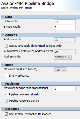

  • global_mm_bridge (pipeline Bridge IP Core) with Support for Transaction Responses

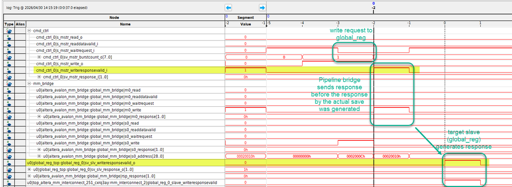

However, when I capture the transactions using Signaltap I noticed that the Bridge is creating a writerepsonse valid before, this is even processed by the addressed slave.  In the signaltap capture, you can see the writereponse (highlighted in yellow) arriving at the initiating master (cmd_ctrl) before, the addressed slave (global_reg) even generates it. Hence I would assume this is generated by the mm_bridge directly after it accepts the write command.

    what you’re seeing is expected: once “transaction response support” is enabled, the Avalon-MM Pipeline Bridge is no longer fully transparent and may generate an early writeresponsevalid as soon as it accepts a write, rather than waiting for the downstream slave, which breaks strict ordering assumptions. There isn’t a setting to force true pass-through behavior, so if your cmd_ctrl depends on the slave (global_reg) finishing its internal processing before accessing another slave, the correct fix is to enforce completion at the slave side—typically by holding waitrequest high until the write is fully processed, or by adding a status/handshake mechanism—rather than relying on the bridge’s response timing.
