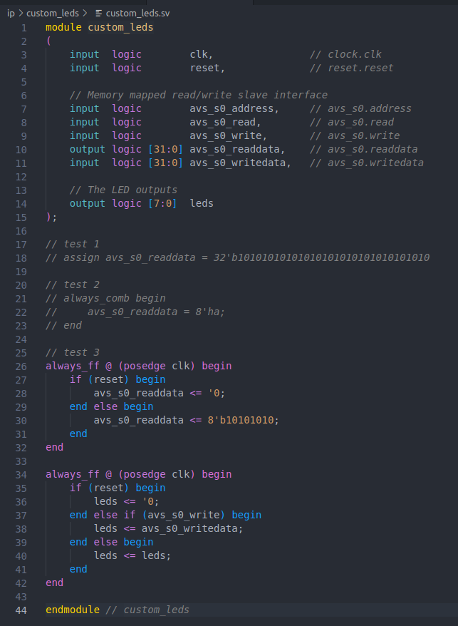

I have this simple Avalon MM slave component where I set avs_s0_readdata to a constant value:

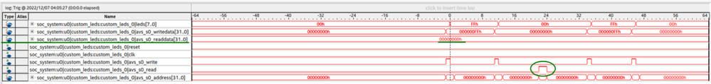

But avs_s0_readdata always stays with value zero. I've tried to achieve this in three different ways, showed in the code commented. Look at this signal tap logic analizer:
readdata is always 0h, even when read signal is enabled. Shouldn't readdata be always the constant value I set in the component's code?

Your clk is not toggling according to Signal Tap, so a better question may be how the writes are working!
