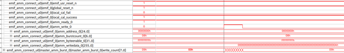

I am using Terasic HAN Pilot development board based on Arria 10 device. I try to write to DDR4 memory embedded on the board which is actually called "DDR4B" , this is a 8Gb x32, and I am able to perform read/writes to DDR4 from EMIF through avalon memory mapped (amm) burst interface with reference designs provided by Terasic with the board.
I want to make my own project to perform read/writes to this DDR4B memory with Intel EMIF IP and customized amm controller. The simple issue is that asserting a write command to the EMIF doesn't trigger any waitrequest_n signal back (also called "ready" signal by EMIF).
Just to assure you, I put the exact same EMIF parameters provided by reference designs. Here is the signaltap output when I assert a write command along with other signals like address, burstcount (8), byteenable :
And if I try to read after asserting the write command, the EMIF seems stalled and I have no readdatavalid. While if I directly read after a reset, I can properly read. So the write command is "seen" by EMIF but doesn't behaves properly !
Any insight is welcome because I understand that the amm control process is trivial.
  • Problem solved, right when I ask for support sorry...
    That was coming from the button input which triggers start of write. This button is bouncing and proceeding multiple writes, so I needed to debounce it.
