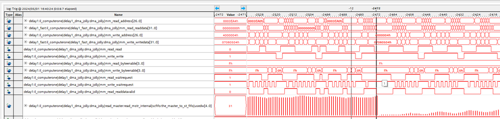

After many trials I've tried to use Signal Tap Logic Analyzer in Quartus: there is a hardware bug that "hangs" the device, it exists only if the IP is configured with TRANSFER_TYPE set to unaligned access (in platform designer).
In the screenshot you can see the last node [...]read_master:read_mstr_internal|scfifo:the_master_to_st_fifo|usedw[4..0] as a bar chart, this is a FIFO in the read_master of the altera_sgdma that overflows. The issue is in the read_master module, its task is reading from the MM Avalon bus and forwarding data to the write_master, it uses a FIFO and has to stop requesting data from the bus early "enough" to not overflow that FIFO. When the module is configured to allow unaligned access it creates the signal (line 751 of read_master.v)
assign too_many_pending_reads = (({fifo_full,fifo_used} + pending_reads_counter) > (FIFO_DEPTH - (maximum_burst_count * 3)));
It assumes a pipeline depth of 3, but it really is 4 deep, because of a barrel shifter in module MM_to_ST_Adapter.v, lines 289-300, that needs an extra cycle to empty itself, after all the reads from the Avalon bus are already done.
The .stp file shows the first time the overflow happens at sample -2472.
