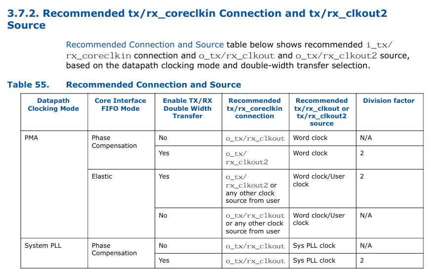

In Section 3.7.2 the clock connections are defined:
I am using PMA clocking, with a Phase Compensation FIFO and 2x Width transfer, which implies the use of o_tx/rx_clkout2, the Word clock and a 2x division factor. Table 61 also suggests we do not need custom cadence gen.

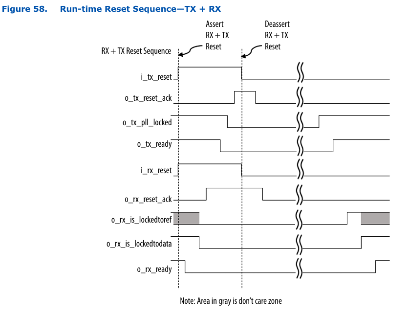

In Section 3.9.6 the reset sequence is defined:
Which implies this snippet should be used at the top level HDL:
always @(posedge system_clk_100) begin
      if (system_reset) begin
            gts_i_tx_reset <= 1'b1;
            gts_i_rx_reset <= 1'b1;
      end else begin
            if((gts_o_tx_reset_ack==1'b1) && (gts_o_rx_reset_ack==1'b1)) begin
                  gts_i_tx_reset <= 1'b0;
                  gts_i_rx_reset <= 1'b0;
            end
      end
end

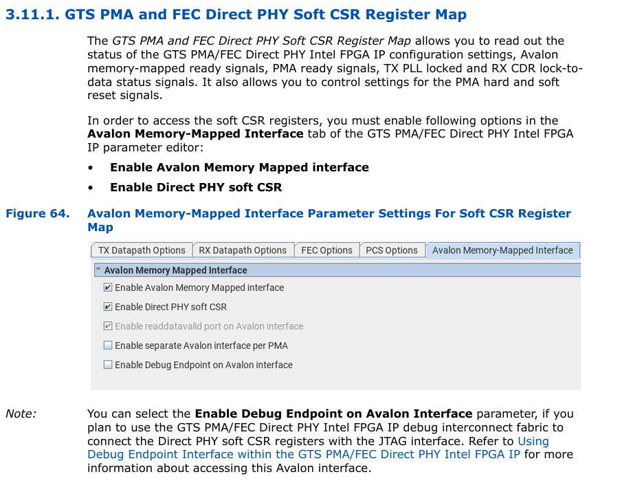

In Section 3.11.1, the JTAG connection to the GTS is defined:
Which suggests to define the following snippet in the HPS definition:
.intel_directphy_gts_0_reconfig_address                           (address_bridge[17:0])

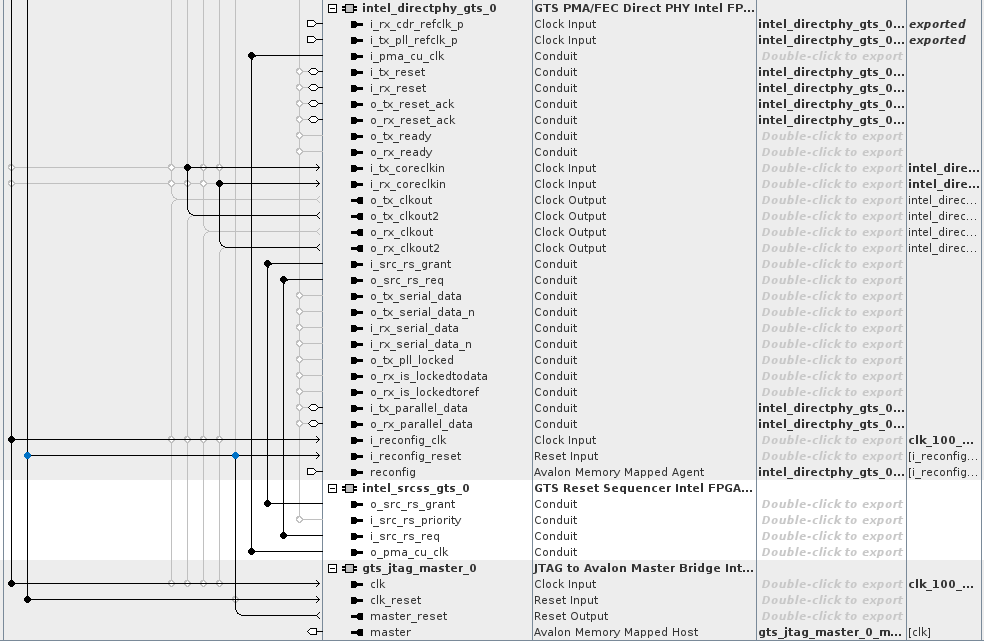

All of this combines into the following GTS configuration and system definition:
GTS PMA/FEC PHY settings changed from default:
Datapath clocking mode                      : PMA
TX/RX PMA interface FIFO mode               : Register
TX/RX clock clock source                    : Word Clock
Enable TX/RX_clkout2 port                   : YES
TX/RX clkout_2 clock source                 : Word Clock
TX/RX _clkout2 div by                       : 2
Enable Avalon Memory Mapped interface       : YES
Enable Direct PHY soft CSR                  : YES
Enable Debug Ednpoint on Avalon interface   : YES
With the following Qsys connections, and top level RTL connections:
