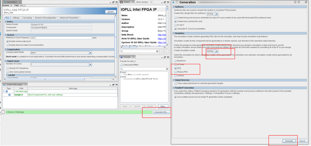

1) Generate Simulation model for VCS
2) go to generate folder

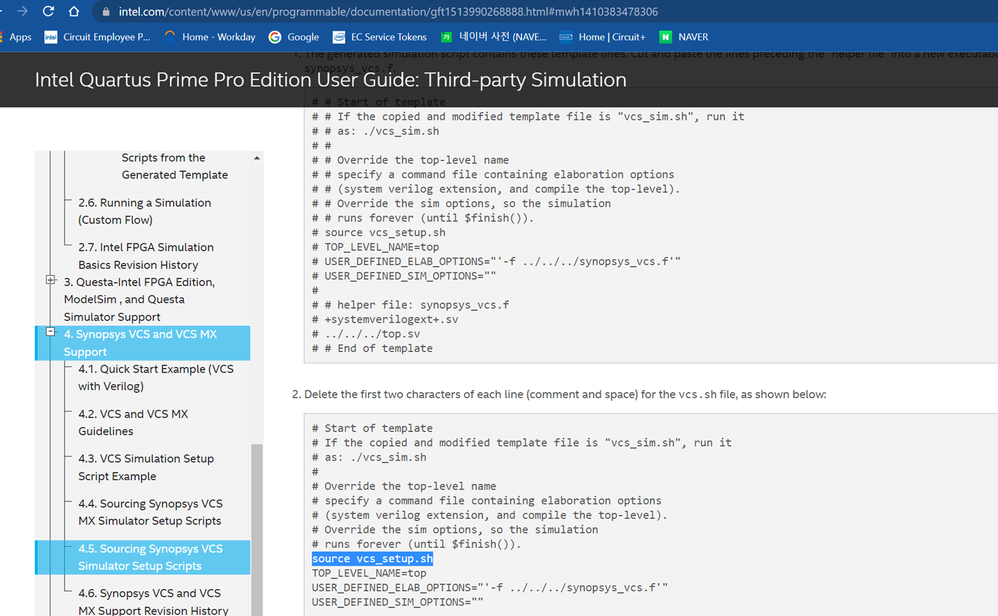

3) This is user Guide for quartus prime pro
4) In server.

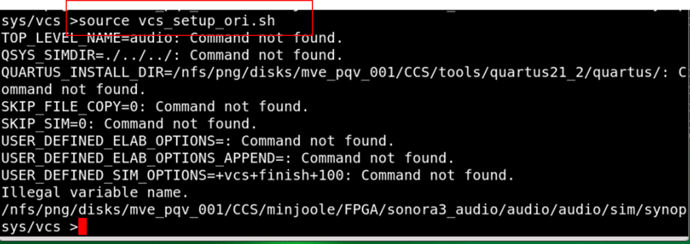

soruce genetated.tcl Not working.

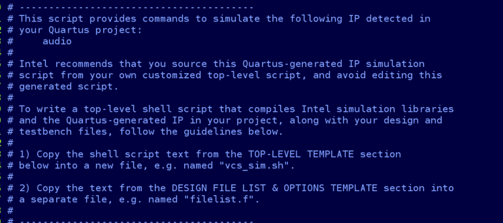

5) Guide and script content not same
this is generated file.
this is guide.
--> How to RTL simulation from quatus pro geneated IP?

    Have you Generate the Simulator Setup Script in the document section 2.5.3.2.1. ?
    Intel Quartus Prime Pro Edition User Guide: Third-party Simulation
    Tools > Generate Simulator Setup Script for IP
    The script should be in vcs_setup.sh or vcsmx_setup.sh files generated in your project directory.
    Please go through Section 2 Intel FPGA Simulation Basics first to understand the simulation flow before go to section 4.
      --> YES
      SEE second screen shots
      1) scripts result are not same as
      2) Without ignore comments in script,
      cmd> source vcs_setup.sh
      should be working. but not.
      3) Can I get simple example such as only 1 PLL design for VCS RTL simulation .
      to see waveform ( generated FSDB )

        I think you are using the incorrect command.
        Try using sh vcsmx_setup.sh instead.
        source vcsmx_setup.sh is for sourcing the Synopsys VCS MX Simulator Setup Scripts.
