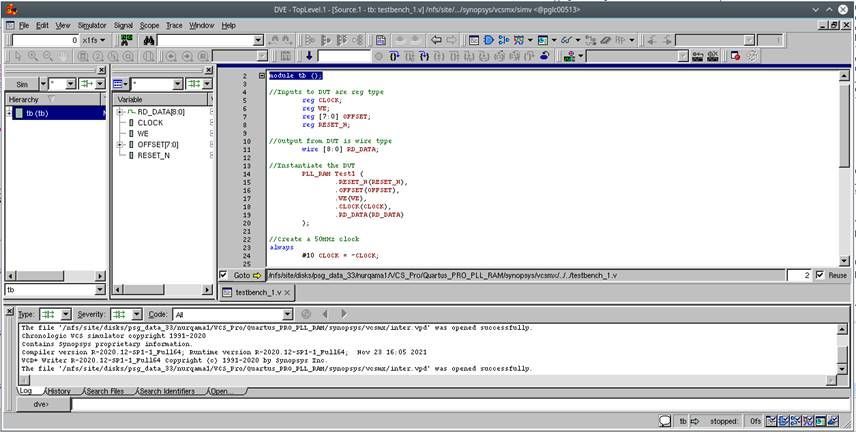

For those who come across similar issue:
To run simulation on the design:
- Go to synopsys/vcsmx
- Type sh vcsmx_sim.sh
- A DVE gui will popup:

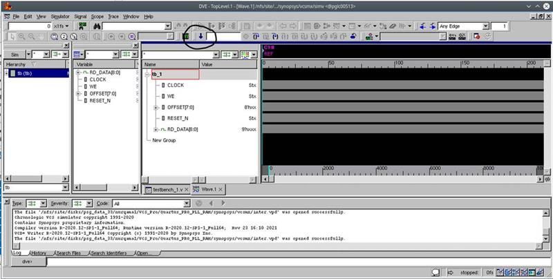

- Click on Simulator> Setup, change the Simulator argument to -ucligui and Click OK
- After that, click on Signals>Add to waves >New wave view to generate waveform window
- Click on the Start/Continue (F5) –see the circled arrow to run the simulation
- The simulation will run till finish with the waveform is updated with the signals in the tb as shown below
With that, I will now transition this thread to community support. If you have a new question, feel free to open a new thread to get the support from Intel experts. Otherwise, the community users will continue to help you on this thread. Thank you.
