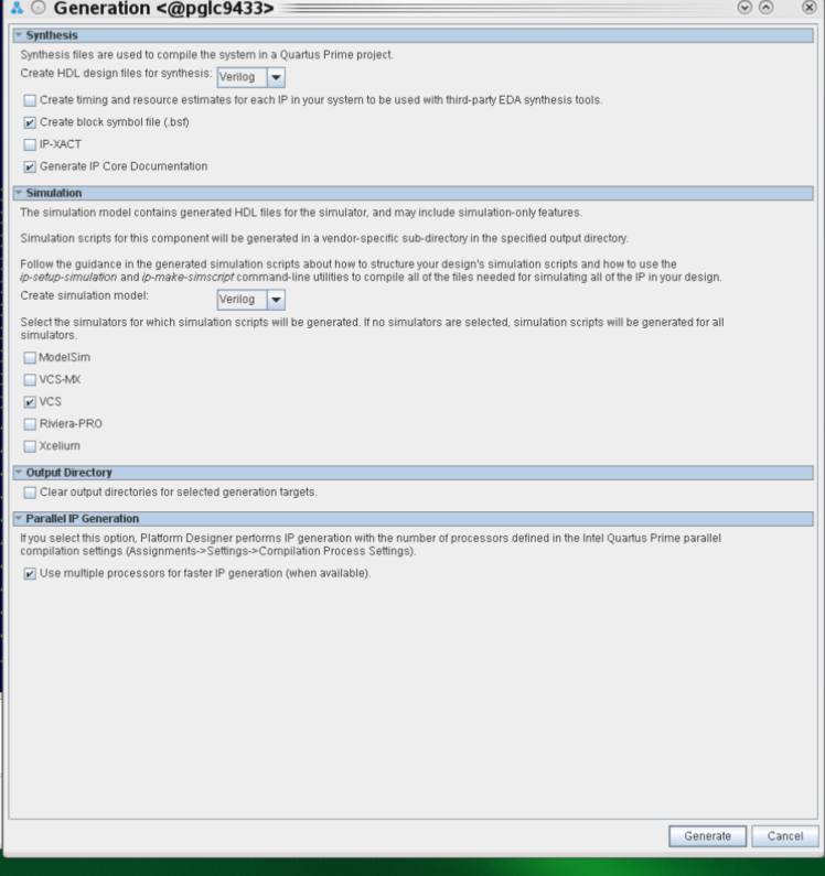

HI , this is my answer
Have you Generate the Simulator Setup Script in the document section 2.5.3.2.1. ?
--> YES
SEE second screen shots

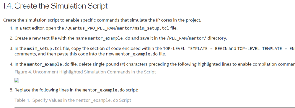

1) scripts result are not same as
Intel Quartus Prime Pro Edition User Guide: Third-party Simulation

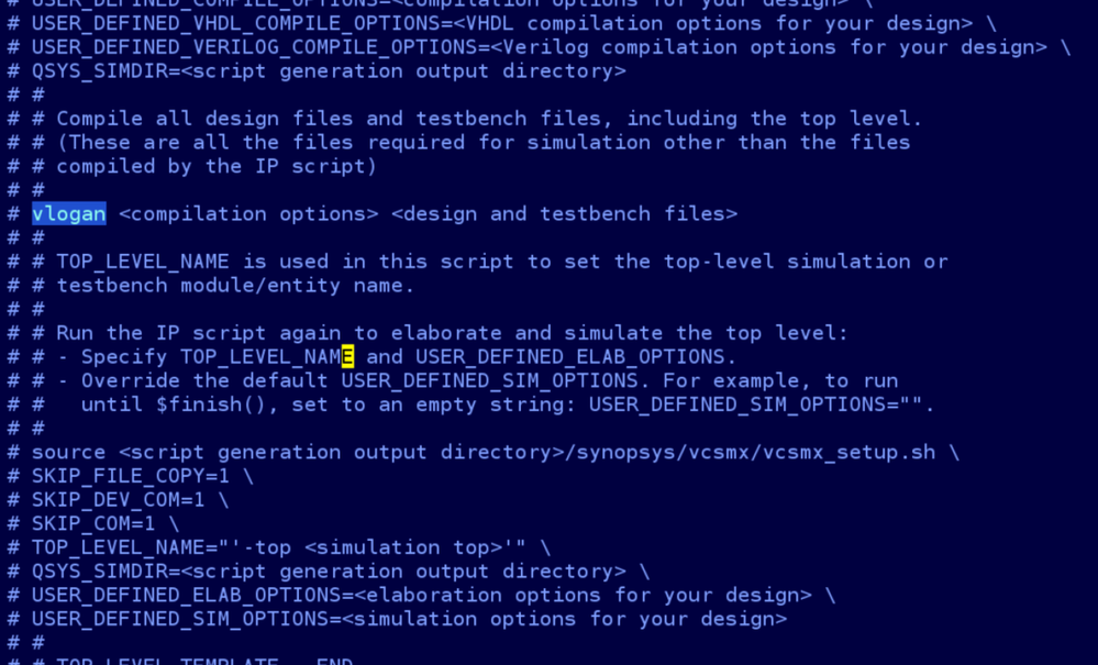

2) Without ignore comments in script,
cmd> source vcs_setup.sh
should be working. but not.

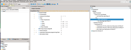

Can you see attachment from Quartus pro
Just generated one PLL which name is test.
In there, there are script for vcs_mx.
1) Script said
source ~~~~~~/vcsmx_setup.sh
--> NOT WORKING ( My problem to run simulation)
2) The template is not said as
Even same Quartus prime pro version as doc,
Why generated script file contents is not same?
Would check it again?

The screenshot resolution is bad to look at but the second screenshot seems to generate HDL for the specific IP. Does not look like it generate the Simulator Setup Script.

2) Actually, In mentor it is easy
A) After generation IP from quartus pro, turn off it
B) just want to run the simple script. ( eaxmple.run)
vlogen /!~~~path /generated_IP_name.v
----MISSING PART (wanted part ) ----------------
vcs top_name -kdb
simv
c) >> example.run
How to do it ?
d) ur example is for using Quartus,
even image link is broken
