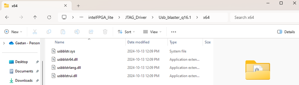

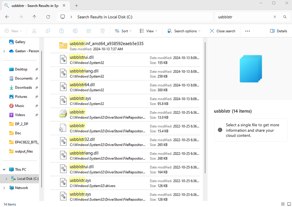

  • SuperxGDx's avatar
    SuperxGDx
    (********************* Solved *********************)
    I have done similar to what was reported by "Roger36" and did not work at the beginning.
    Then, I put the drivers into the "C:\Windows\System32" directory (See attached).
    Do not recall if I have rebooted though.
    Working fine for me now, verified with for Quartus 18.1 and 22.1.
    - Downloaded USB Blaster driver for Windows 10 from
    "File:Usb blaster q16.1.zip - Terasic Wiki"
    - In device manage, update the driver in "Device Manager" as per "Roger36" for USB Blaster.
    - Put the files into the directory as reported before, See image attached for the file names.
    Wish you all the best.
    SuperGDx

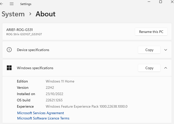

  • Arief-AK's avatar
    Arief-AK
    Hi all,
    To formally reply to the initial question by @Farishb , I was able to make my windows 11 machine recognise the device by reverting back to Quartus Prime 18.1. You can download Quartus Prime 18.1 using this link (https://www.intel.com/content/www/us/en/software-kit/665990/intel-quartus-prime-lite-edition-design-software-version-18-1-for-windows.html)
    FPGA:
    Model: Terasic FPGA DE-10
    Device: Intel Cyclone V
    Background:
    I had installed Quartus Prime 22.1 prior to Quartus Prime 18.1. I encountered the unrecognised driver issue as well. I have tried to fix it with the solution from @Roger36 to no success. Hence the rolling-back to Quartus 18.1.
    To my surprise, during the installation for 18.1, I was prompted with the install USB driver checkbox. I then continued with the installation. When the FPGA is connected, the driver should be installed under JTAG cables in the device manager.
    Device Manager (FPGA not-plugged in)
    Windows 11 Info
    Hope this helps someone!
    Arief.
