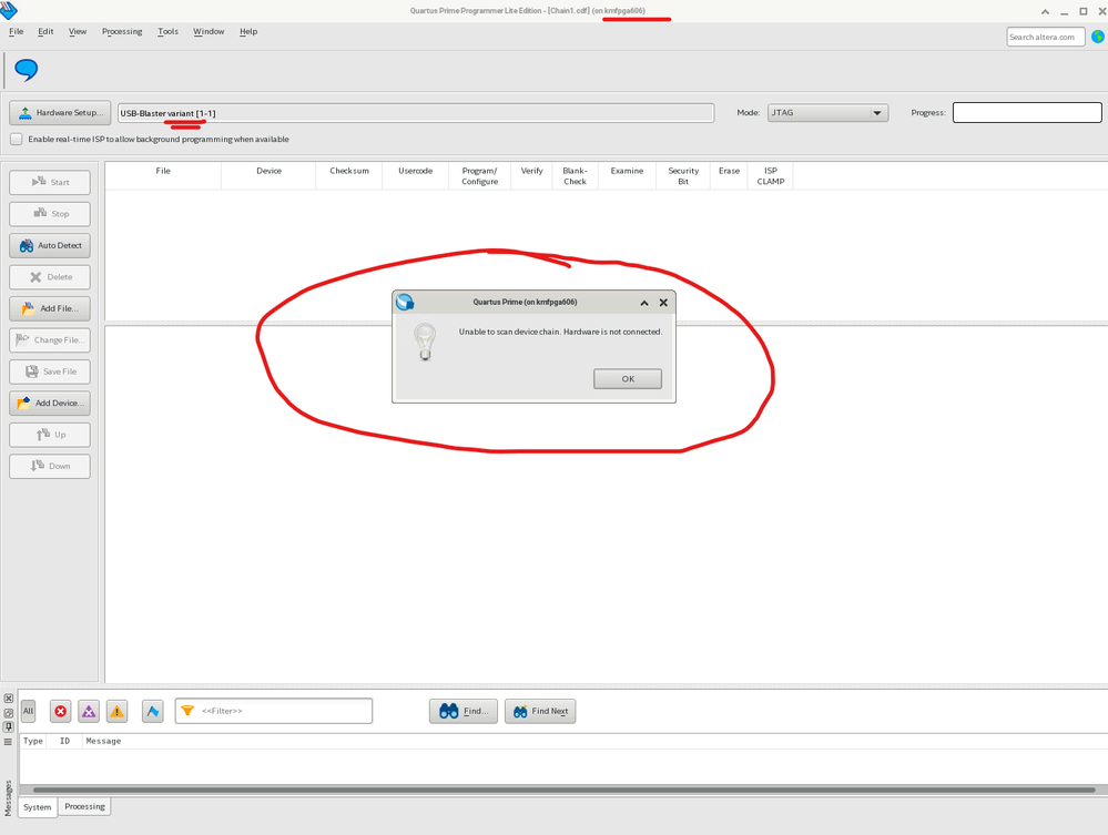

[USB-Blaster] Detected as "USB-Blaster Variant" on SLES12 – Causing Detection Issues
I'm facing an issue where the USB-Blaster is automatically detected as USB-Blaster [Variant] in a Linux environment (SLES12), instead of the standard USB-Blaster.
Because of this, my system is unable to detect the testcard, and scanning fails completely.
Has anyone encountered this issue before? Is there a known fix or driver workaround for this behavior?
Current OS: SUSE SLES12 SP5
Kernel Version: 4.12.14-122.255-default
Issue: USB-Blaster is consistently detected as USB-Blaster [Variant], causing device scan failures.
Previous OS: SUSE SLES12 SP5
Kernel Version: 4.12.14-122.201-default
Status: USB-Blaster was detected correctly and worked without issues.

    I’ve tried the BKM you shared, but unfortunately, it didn’t resolve the USB-Blaster Variant issue.
    Even with the latest Quartus Pro and updated driver, the problem still persists.
    Please let me know if there’s anything else I can try.
