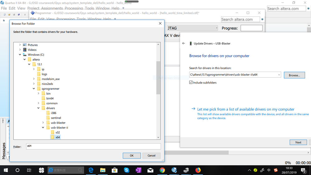

I came across a very tricky problem. My DE0 board could not connect to windows 10 due to missing drivers.
After manually using quartus ii 13.1 usb driver *64 sub folders, still computer cannot recognise the blaster.

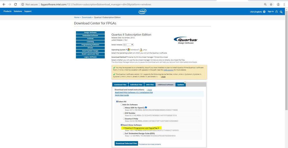

Could you please check with installing standalone programmer using below,
you can also check by reinstalling the Quartus 13.1 setup.

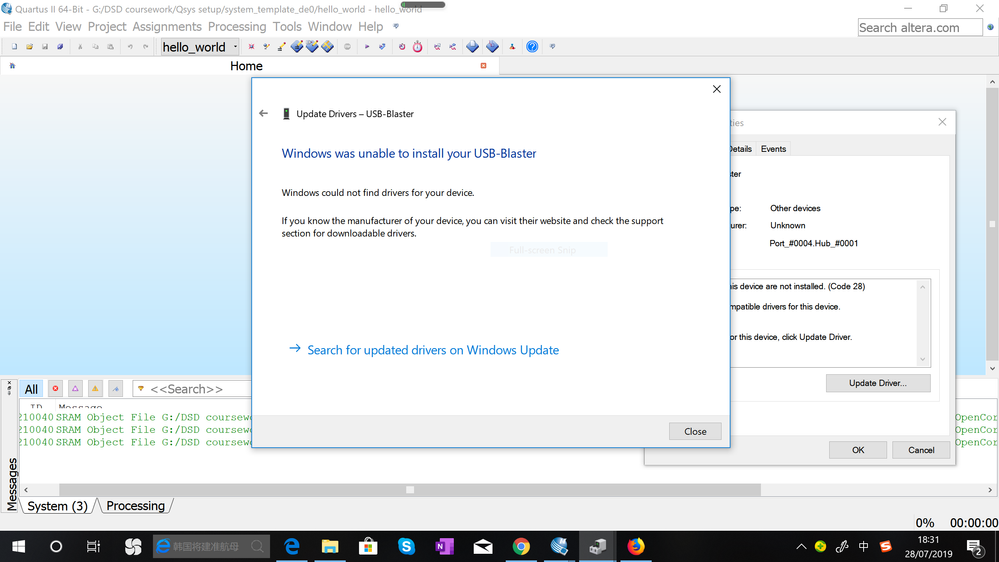

Here is the result of my driver situations:
This always happens, even if I download the stand alone software as you suggested.
Probably I need to redownload my software.
