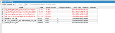

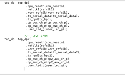

I have generated an example design for display port which compiled successfully. As we are dealing with 2 display ports i made a second instantiation of the same example top. this time i got a timing violation in the following path, which I could not solve. But the project is working fine when I test in the board. Can you please help me to solve this timing violation?
Here is the details of timing violation
ex:
Critical Warning: Unexpected timed setup path
From: top_dp|tx_phy_top_i|gxb_tx_i|gxb_tx|g_xcvr_native_insts[0].ct2_xcvr_native_inst|inst_ct2_xcvr_channel_multi|gen_rev.ct2_xcvr_channel_inst|gen_ct1_hssi_pldadapt_tx.inst_ct1_hssi_pldadapt_tx|pld_pcs_tx_clk_out2_dcm
To: top_dp2|tx_phy_top_i|gxb_tx_i|gxb_tx|g_xcvr_native_insts[0].ct2_xcvr_native_inst|inst_ct2_xcvr_channel_multi|gen_rev.ct2_xcvr_channel_inst|gen_ct1_hssi_pldadapt_tx.inst_ct1_hssi_pldadapt_tx~pld_tx_clk2_dcm.reg
Source Clock: top_dp|tx_phy_top_i|gxb_tx_i|tx_clkout2|ch0
Destination Clock: top_dp2|tx_phy_top_i|gxb_tx_i|tx_clkout2|ch0
component instantiation.
refclk1 is 100MHz
xcvr_refclk is 135Mhz

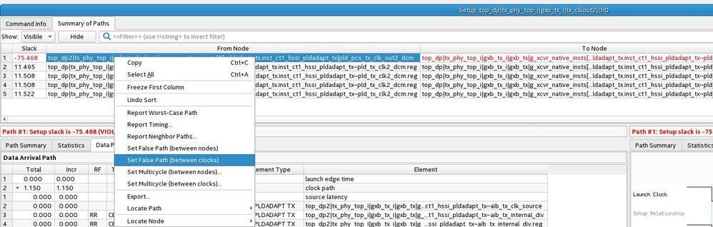

  • When you report timing the failing slack, in the timing report, you can right-click the failing path, Set False Path(between nodes or clock). In this case, this seem to be clock-to-data analysis.
    Select Set False Path (between clock) > Update Timing Netlist > Setup Summary. You will see the first timing violation has gone. Repeat the rest of the timing path violation (make sure to check whether the timing path can be false path.)

  • There is a possibility that the timing violation you are seeing could be a false path.
    You need to review and check whether the timing path mentioned in the violation is relevant to the circuit's operation.
    If you believe it is a false path, you can use the 'set_false_path' command to exclude that specific path from the timing analysis.

      i used false path command in that specific path, even that didn't solve the problem.
