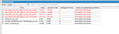

Timing violations while integrating 2 display port example designs..
There is a possibility that the timing violation you are seeing could be a false path.
You need to review and check whether the timing path mentioned in the violation is relevant to the circuit's operation.
If you believe it is a false path, you can use the 'set_false_path' command to exclude that specific path from the timing analysis.

i used false path command in that specific path, even that didn't solve the problem.
