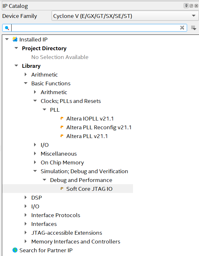

There are a lot of IPs that can't be found in IP Catalog
As shown in the image below, I wanted to use In-System Sources and Probe ip core, but I couldn't find it in the IP Catalog.
I used the quartus 18.1 standard version but didn't find the IP core, so I installed a quartus21.1 standard version but still couldn't find it.
There are also problems with similar PLL ip cores, which used to display PLL Intel FPGA IP, but after reinstalling the software, it became Altera PLL.
This seems to have happened after I installed patch 0.05.
This is normal on another computer. If you know how to fix it, trouble tell me.

        The Intel® Quartus® Prime software searches for IP cores in the project directory, in the Intel® Quartus® Prime installation directory, and in the IP search path.
        Make sure also the ip cores file is in the Intel® Quartus® Prime installation directory. If not, you may need to locate the ip cores file path by going to Tools > Options > IP Catalog SearchLocations

  • I didn't install other versions until I uninstalled 18.1. I've tried to clear the registry and environment variables after uninstalling the software, and it's the same thing. Maybe I need to reinstall the Windows system to solve it

    That is very strange. I'd do a complete uninstall and reinstall of the software.

      Yes, even if I use the tool to completely uninstall (including the registry) and then reinstall it. As I mentioned in the article, for this reason I changed to the latest version of quartus prime is also not solvable. This seems to have been caused after I installed ''patch 0.05'' and I was able to use it normally until then.

        Did you or do you have other versions of Quartus installed on the same machine? Quartus is picking up this list of IP from somewhere local, so all I can guess is that it might be seeing a different installation. Delete all versions of Quartus you have installed, and restart. Check your environment variables too to see if maybe there is an older path pointer in there that is affecting things.
