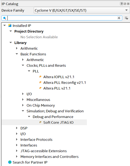

I tried to install patch ''quartus-18.1std-0.05std-windows.exe'' to Quartus Std 18.1. Seems like there is no problem with ip catalog on my end. The patch probably should not have any problem.

Thank you for your reply,
It seems like something is wrong with my computer. I use the same installation to install on another computer and it works fine.
Although I didn't find in-system sources and probes on the IP catalog, it works when I generate an IP core from another computer and copy it onto my computer.- ShengN_altera4 years ago
The Intel® Quartus® Prime software searches for IP cores in the project directory, in the Intel® Quartus® Prime installation directory, and in the IP search path.
Make sure also the ip cores file is in the Intel® Quartus® Prime installation directory. If not, you may need to locate the ip cores file path by going to Tools > Options > IP Catalog SearchLocations
Sheng - ShengN_altera4 years ago
Did you install the software with antivirus on? Temporary turning off your antivirus software may help.
