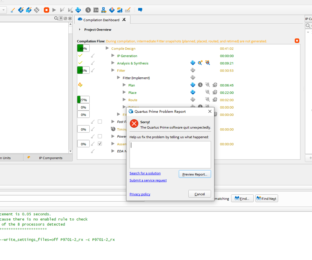

The Quartus Prime software quit unexpectedly!
I frequently encounter this error during project compilation, which typically occurs during the filter process and happens after several hours of compiling. It severely wastes time and reduces work efficiency. Has anyone experienced the same issue?

6 Replies
