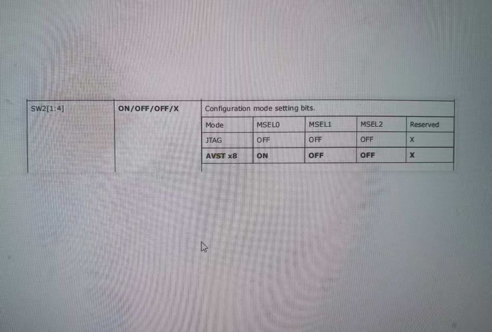

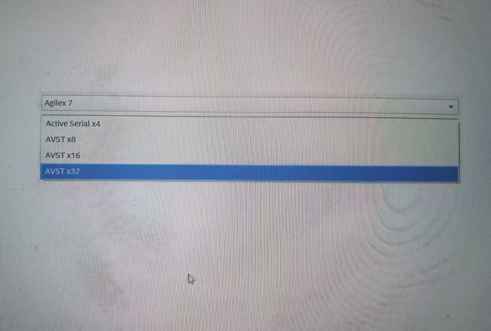

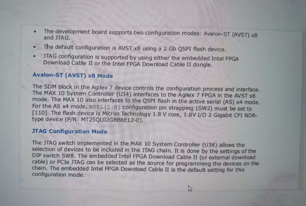

    • xingyunzhidi's avatar
      xingyunzhidi
      I checked the SW section in the FPGA manual. When I set the SW as per the default configuration, I encounter the previously mentioned error ("unable to scan the JTAG chain") and BTS is unable to detect it. However, when I set SW2.1 to OFF (i.e., JTAG instead of AVST×8), it is recognized correctly, and BTS can detect it and program the FPGA with the .sof file. The FPGA manual mentions two configuration modes, but when generating the .pof, it seems like only the AVST mode can be selected. How can I generate a .pof for the JTAG programming mode (with SW2.1 set to OFF)?
