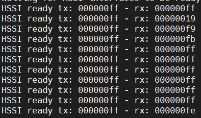

However, after changing both of them, the rx_ready is always fluctuating, and never stable at 0xff.
So, i'm at loss on how to actually use this hssi interface. I tried looking into the transceiver user guide but still don't understand how to use it. Can someone please advise me how to use the interface correctly?

After several seconds, the RX_READY seems to assert well. but I couldn't found the correct data in the rx_parallel_data. using the same code.

After further investigation, the TX_READY and RX_READY will not have anything to with the PRBS module. The TX_READY and RX_READY will be related to the interface readiness. Have you check if this issue is not happening on the original design?
- yashael
Yes I can confirm that those signal is asserted if given enough time. But why is the data on the receiving end differs from the transmitter? I observed a kind of shifted value on the receiving end. Do I have to implement an error correction module?
