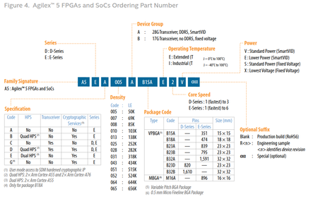

Hello i have a question about agilex 5 security features. From what i understand - all agilex 5 devices have access to SDM, but this image shows that A and C type of devices cant use it. ...

Hi.
You can use the device type C as well if it is purely FPGA based design and you can have encrypted bitstream for your design.
In device type C, it doesn't have HPS(Hard Processing System) i.e. no arm cortex cores.

1 year agoHi.
